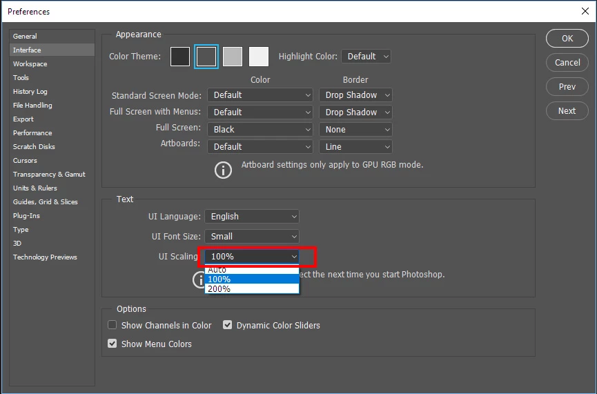

In Photoshop Preferences  you want Photoshop's  "UI Scaling" set to 100% not Auto or 200%.

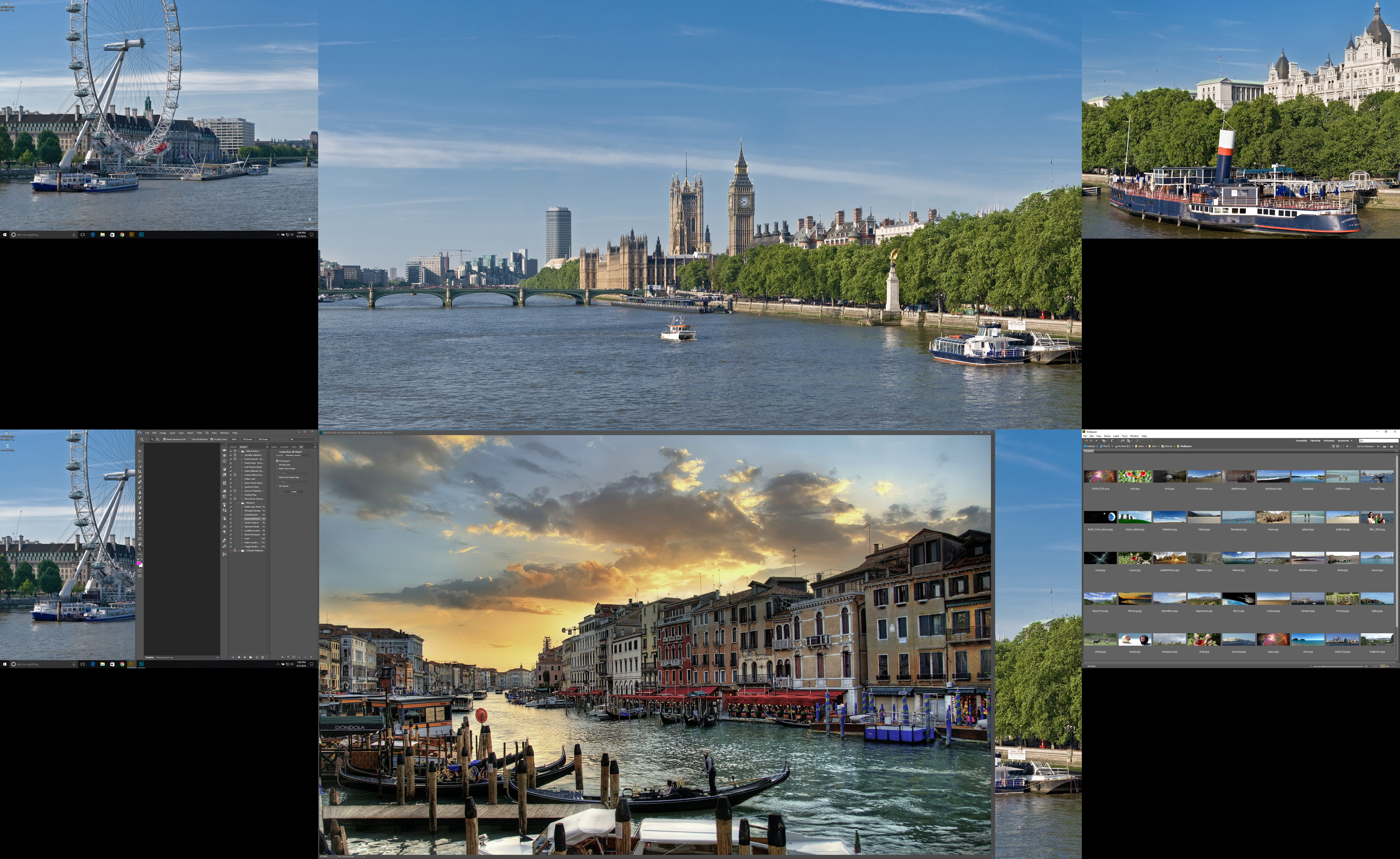

On Windows I have Windows scale my 24" 185DPI $K display scalled 200%.   Photoshop Tell Windows it will handle  Scaling so Windows does not scale what Photoshop displays on information on my 4K display. Windows will scale what other applications display on my 4k Display.  I create mt wall paper in three section at two different scales two sections for my two 100DiP displays and one section for my 185 DPI 4K display.

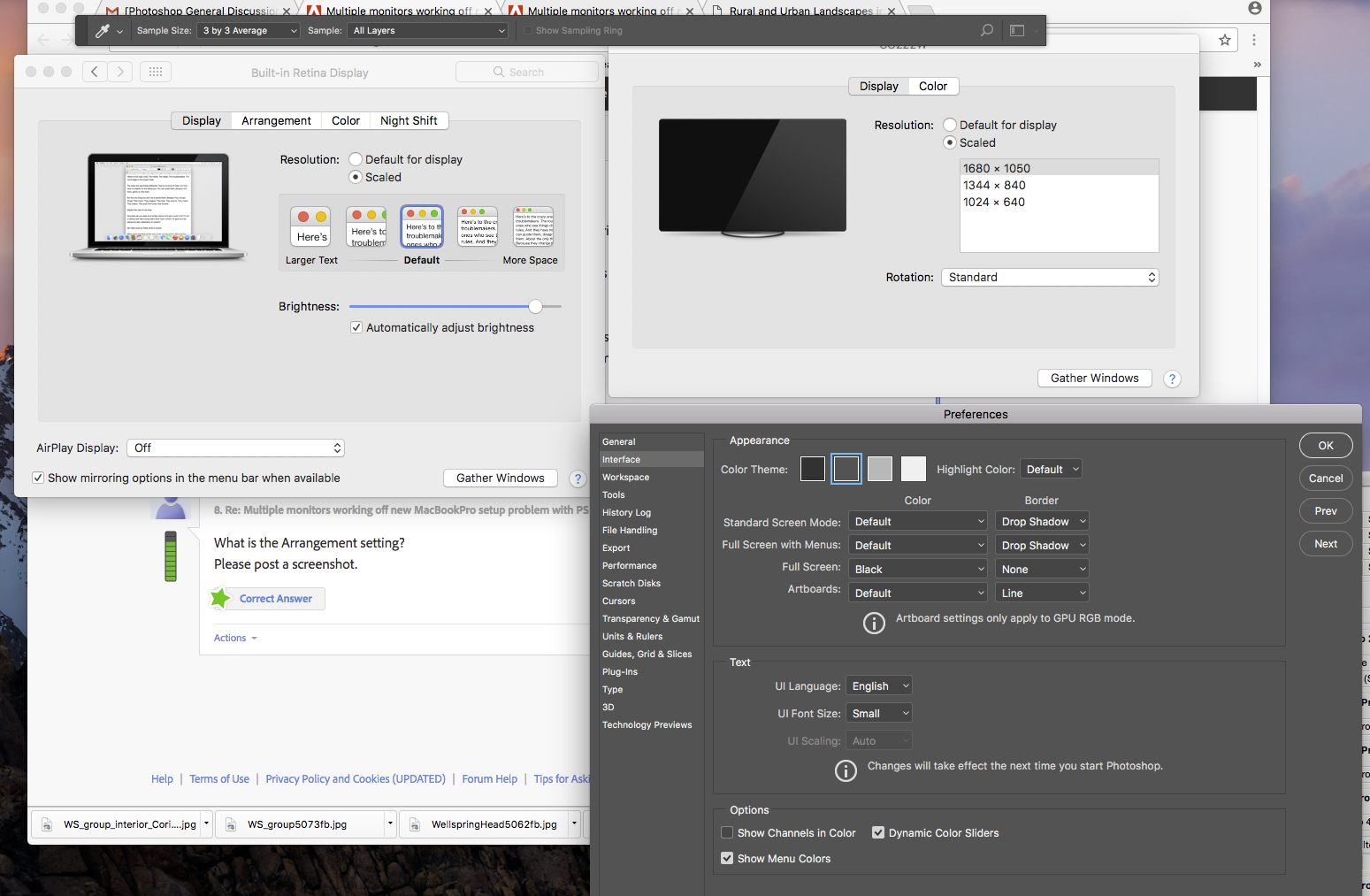

Wow. Sweet setup you have there! I went to my PS prefs on my Mac (they looked just like yours on the PC) but the UI scaling is grayed out. I am not able to change it from auto to 100%. Any ideas how to get around that? Thanks for your time and expertise.

Its the difference in displays resolution.  Your internals display most likely has a High DPI resolution and your external displays has a low resolution display.  If you use Photoshop 2X UI scaling so you can see Photoshop UI on your MacBookPro Display  Photoshop will also scale your external display 2X so Photoshop Palettes will display huge on you external display. To get around this problem do not use Adobe Photoshop 2X UI set UI scaling to 100% not Auto or 200%.  Have Photoshop UI on your external display and edit your image in floating windows on the macbook's display.

Thanks for the responses! JJMack, what you have stated makes sense to me. I am not able to see where I should change my settings for the display and scaling. Is this under System Prefs on the Mac or prefs in PS?
I am currently using an Eizo ColorEdge CG222W monitor along with the MacBookPro 2015 Retina, 15", running 10.12.5.
The built in Retina resolution is set to default. The Eizo is set to default, which I think is 1680x1050?
