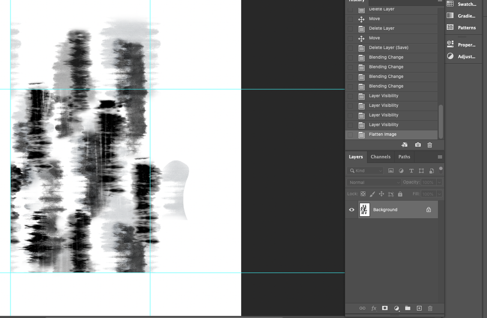

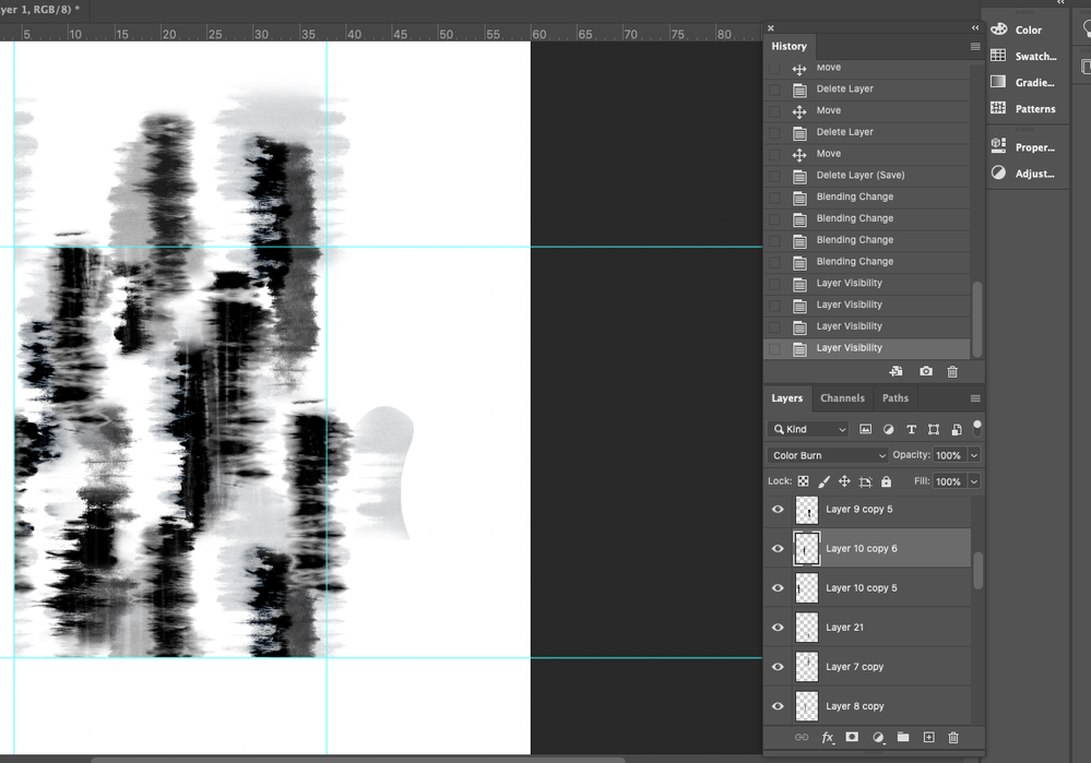

Could you please post a screenshot taken at View > 100% with the pertinent Panels (Layers, Channels, Options Bar, …) visible?
Before and after flattening.

before flatteningbefore flatteningafter flatteningafter flattening

this print is quite large so if i take the view to 100% its super zoomed in. The elements are bitmapped too so not sure if thats playing a part in the problem
Aug 05, 2020 Aug 05, 2020
You must compare the before and after at 100%
When zoomed out, blending is done using the downsized preview versions of the layers. That downsizing introduces values not in the image. In addition, at zoom levels less than 66.7% 8 bit previews are used even when the image is 16 bit. All this is done for speed. In 99% of images it makes little difference, but in a few the difference can be significant.
In short , always check before and after flattening at 100% zoom.
