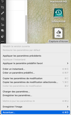

Aug 24, 2022 Aug 24, 2022
Long story short : divide the width by 300 and you will get the real printable size (in inches).
I.E : 1920 px/300 : 6.4 inches wide.
Also check the preferences > Tech something and check the first box
Then when you will resample an image select this option in the dropdown menu.
Also Camera Raw has an option to enlarge; you can find it on the tree dots side menu. It will raise the resolution with less quality loss.
Hope it will help 
