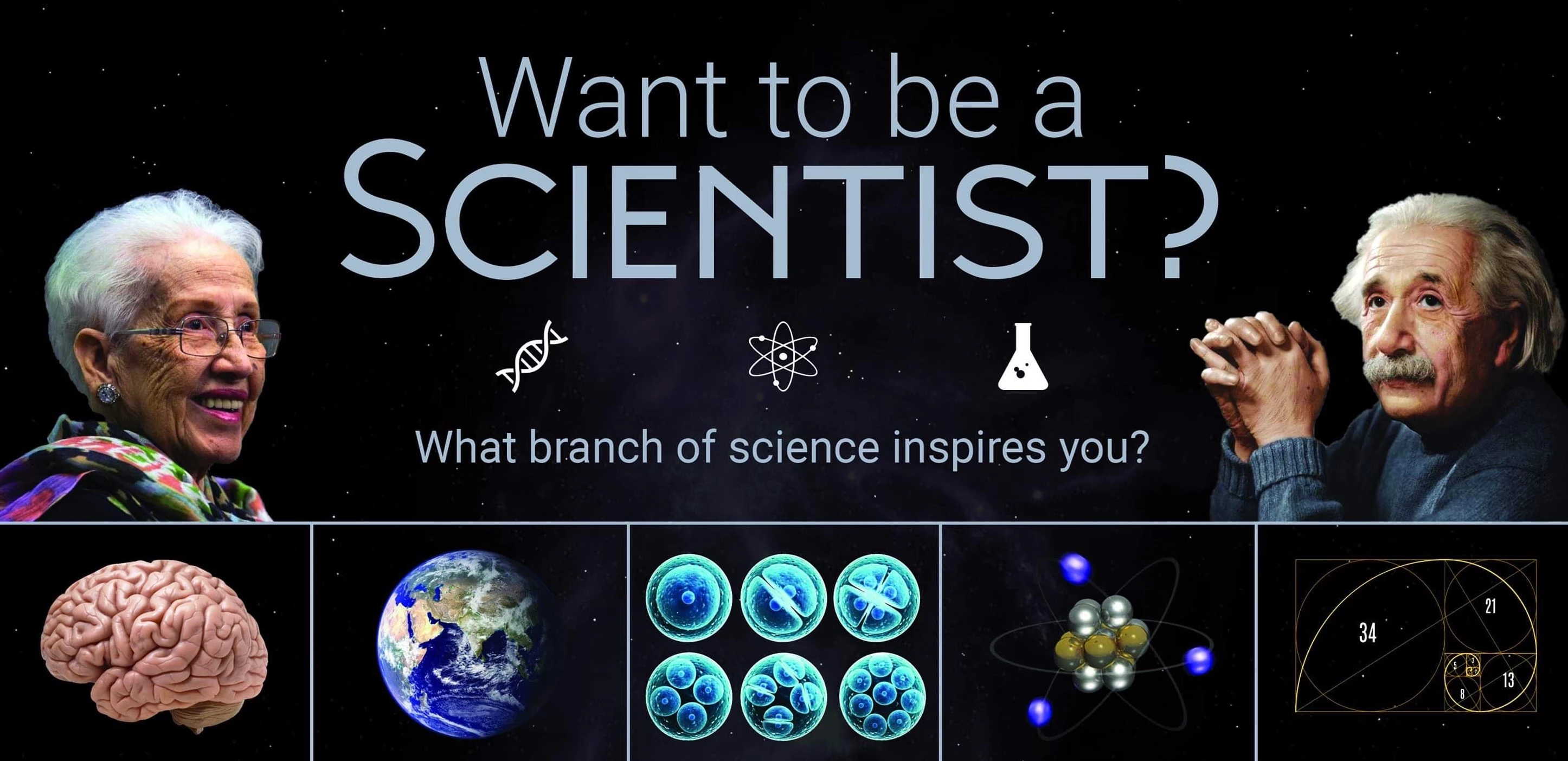

I am creating a poster and I set up a project in CMYK because I want to print it, here is the image. (Normal colours)

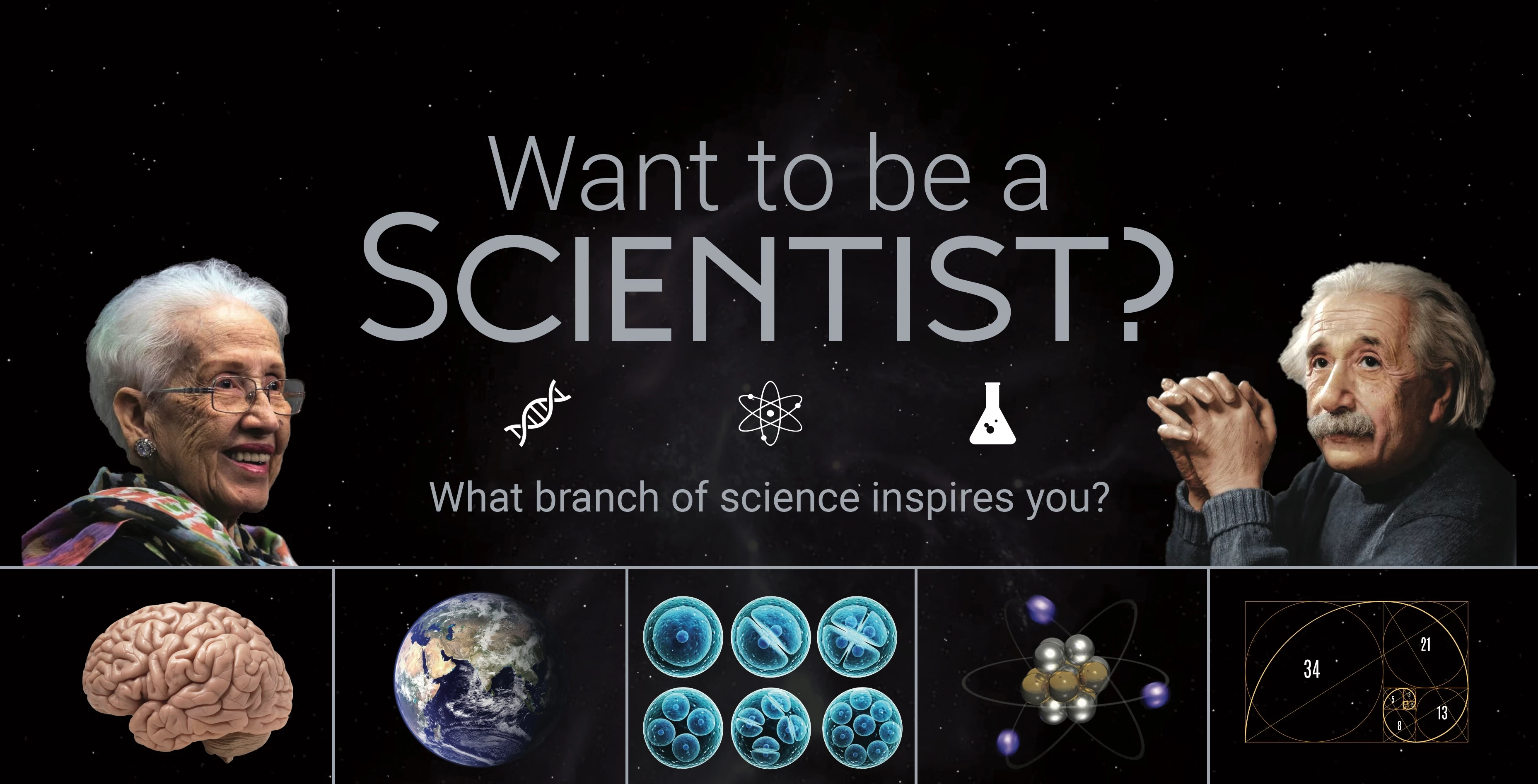

I then created a new canvas with the same settings as the original, the same dimensions, resolution and CMYK format and I transferred my poster into the new canvas (Drag and drop). The problem is the colours have shifted into a dull shade, I don't understand what's happening or how to fix it. Can someone please help. I will post another image of what the poster looks like with the wrong colours.

First, what version of Photoshop are you using? Are upi pm a Mac or Windows machine? Can you show us a screen capture of your Photoshop window -- especially the title bar with the Document Title tab for both the original and new versions? If both files are CMYK and the settings are the same, there should be no shilft. If you set your first version up in RGB and your second in CMYK--that would account for the shift in colors. In the second image you posted, I can see the desaturation especially in the blues which is very typical of CMYK. Something to remember -- the CMYK color space is much smaller than RGB (less colors to work with)
