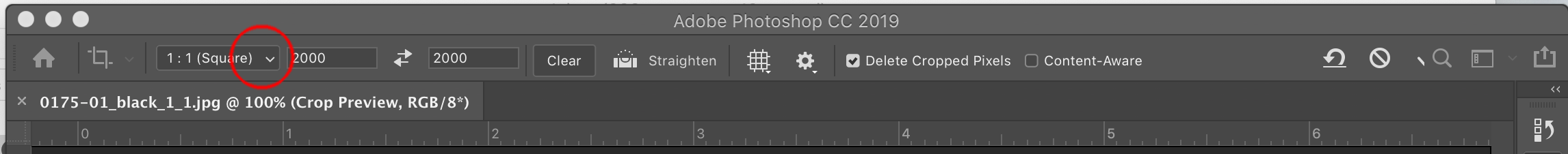

Yes you set res here. Sorry should be PX not inches for 2000.

I don't find this place on my tool bar, do I need to open something different?Screen Shot 2019-07-29 at 1.54.19 PM.png
Jul 29, 2019 Jul 29, 2019
Slow down, relax. Is very basic and easy.
Click here
Change to w x h x Res
