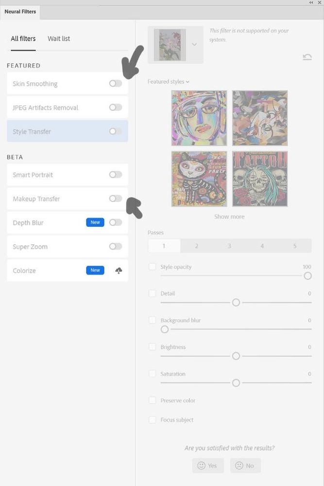

I am able to select Filters > Neural Filters. The Neural Filters panel is all greyed out. I am able to click different filters but all options are greyed out and unable to select. Please help to fix this issue. Thank you.

You need to toggle the switch behind the name of the filter.

The Neural Filters panel is all greyed out. I am able to click different filters but all options are greyed out and unable to select. Not able be turn the Filters on/off either.
Attached is the screenshot...

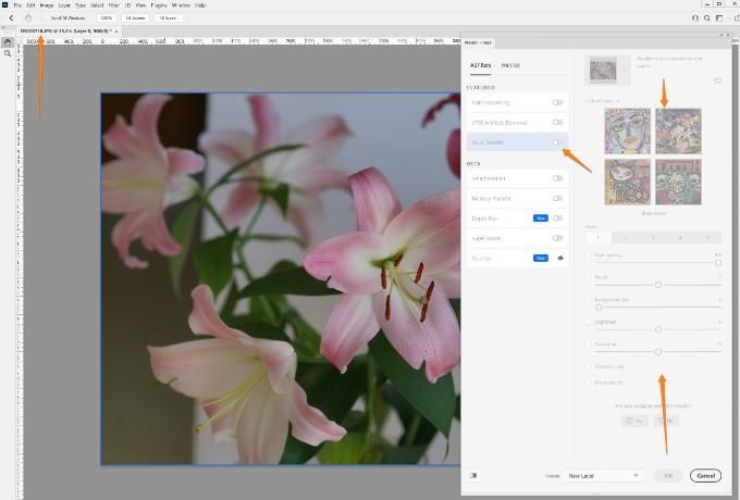

I looked at your initial screenshot again, and I noticed that even though the image is a jpeg, the screenshot shows that a layer is selected. Jpeg files do not have layers of their own, so this must be a layer that you added. Could that be the explanation? Did you perhaps select an empty layer? I never tied (and as I am typing this on my iPad I cannot try it), but I could imagine that the filters are dimmed if they cannot work, and they can’t work on an empty layer.

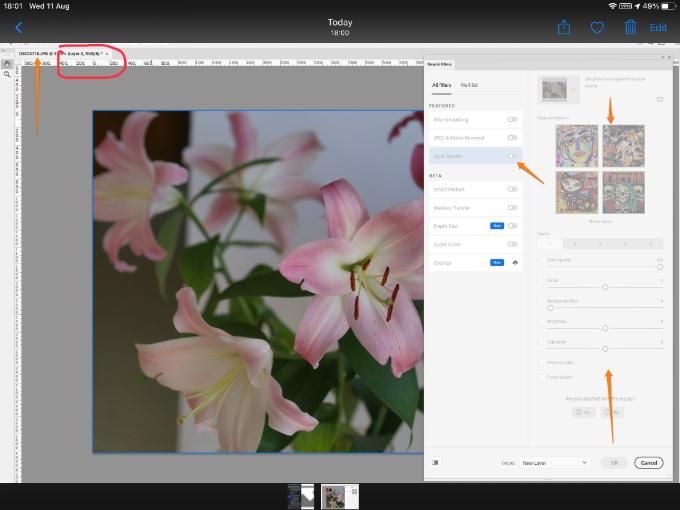

@Johan_Elzenga I opened a JPEG. Did not do anything to it. Clicked Filters > Neural Filters. Still the same issues.

Oddly enough, your screenshot shows once again a layer…
