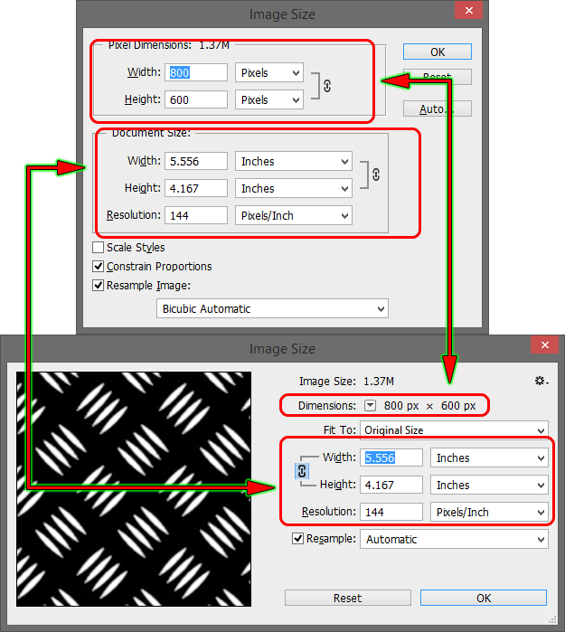

Not to sound smug, but I think you guys are not quite understanding how the image size works. Remember, pixels = screen size, and size/inches = print size. One can change without the other changing. How? By changing the resolution.
There are 3 parts to the image size equation: pixels - resolution - size (inches we'll say). Resolution is always the link between pixels and size.
If you have the measurement set to pixels, changing resolution will affect the size/inches (if you wanted the pixels to be changed, you'd simply just change the pixels, right?). Try it: Open up the image size box, and make sure your measurement is pixels, now switch to inches JUST to see what it is. Switch back to pixels and change the resolution - nothing happened right? Wrong. Go back to inches. They changed, didn't they?
Try the reverse. If you have the measurement set to a size (inches), changing the resolution will change the pixels. Why? Well same as above, PS assumes that if you wanted to change the size/inches when you're on that setting already, that you'd simply just change it. So, PS "preserves" the value of whatever measurement you have selected (inches), but changes the correspondng one (pixels) when you change the resolution AND vice versa.
Here's how to think of it in a real world example:
I have an image that I want to print. It's 500 pixels at 100ppi meaning 5" in diameter (500 pixels divide by 100 ppi = 5"). Well, I'm kind of concerned about the print quality I'll get at 100 ppi. So, I go into my image size box, and make sure it's set to pixels. Now, I don't want to change the pixels (resampling) because that could grunge up my image, so I change the resolution to 300 ppi and PS makes sure my pixel dimension stay at 500 pixels. BUT, to compensate and make the pixels-resolution-size math equation stay true, I'll find that my inches got changed to 1.6". So, yes I got my 500 pixel 300 ppi/dpi high qualiity image, but had to downsize to a 1.6" print to get it.
Now, kind of an opposite (but slightly stupid) example. Let's say I have a 500 pixel, 300 ppi, 1.6 " image, and I want to make it bigger for my website (1000 pixels lets say), BUT, I don't want to change the inches of the image because I'm going to print it later and want it to remain 1.6" (yes, I know, normally you would just save an additional copy). So, I open up my image size box, make sure inches is selected, and then change the resolution to 600 ppi. Well, PS won't change the inches (because if I wanted to do that, than I just would have done that), but it WILL change my pixels to 1000 pixels so that ole' pixlels-resolution-size/inches equation works out (and keep the image size at 1.6").
In summary, think of changing resolution as a way to change either pixels, OR size/inches, while leaving the other one un-changed. IF you leave the resolution the same, but change the size/inches, than pixels HAS to change to keep the math equation true, and vice versa.
Make sense?

With my Rulers set to pixels, this worked fine for me:
New Here ,
Jan 09, 2014 Jan 09, 2014
Thank you Semaphoric that did the trick!!!
With my prefrence rulers set to pixels all I had to do was change my width/height to inches before I adjusted my pixels and it worked. You have saved me much frustration and time.
You're welcome. I must say that I found the new dialog quite off-putting, too. But, once you grok the correspondence between the two, you can see how the new features add power:
