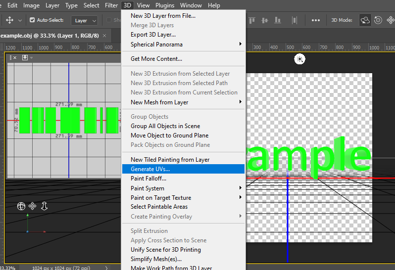

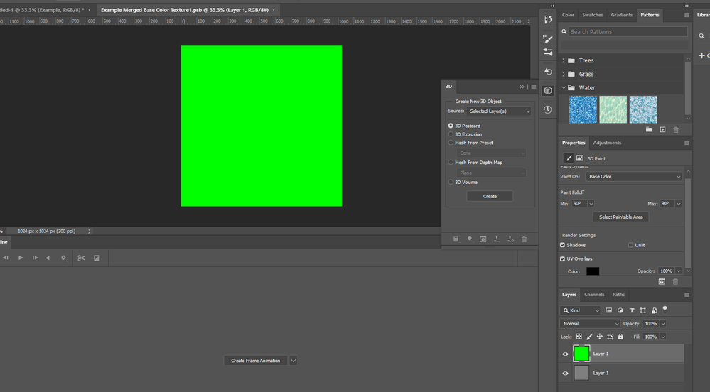

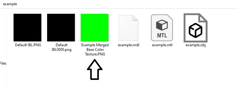

if you export the object as wavefront Obj with Png textures you will get a [standard square] texture map yes... upload that with the Obj and the Mtl or edit the texture map to be whatever other colour you want
Screenshot (1030).pngexpand imageScreenshot (1028).pngexpand imageScreenshot (1029).pngexpand image
p.s, if you don't have a map in your export then you go back and generate UV and try again... the default colour is gray but just change it

wavefront Obj is the model itself
the mtl file is like a list that says what other images to load onto the Obj and which face has what image
the textures can be colour codes but image textures are the standard and what moden system expect... in my example you would zip the Obj with both the mtl and at least the green texture map inside the zip folder then upload it
I don't use the "Magic Music Visuals" so you would be better asking them what format options you have but a Obj file on its own doesn't have any colour no... you need the mtl or at least software which can generate a default mtl at the other end
