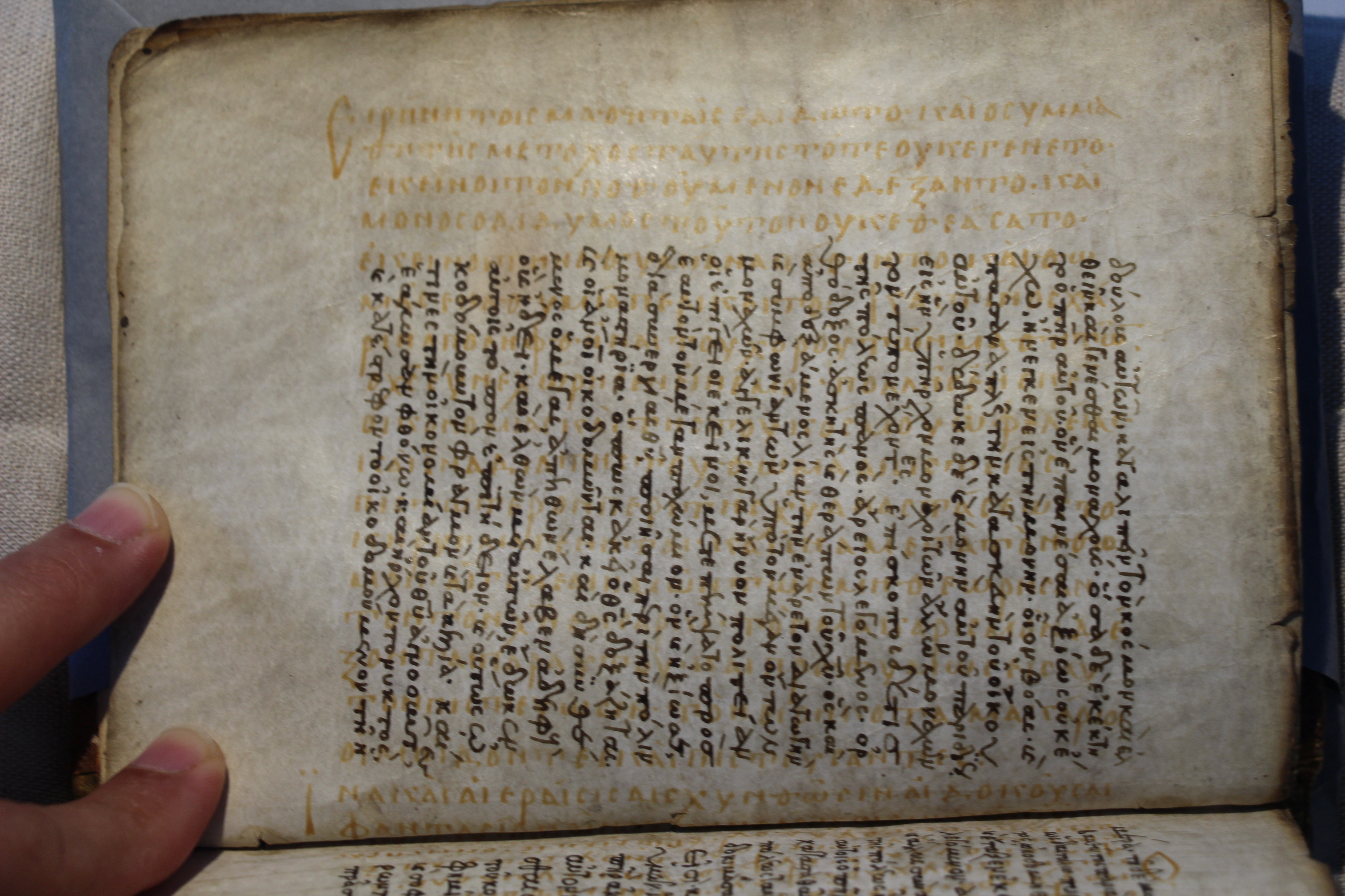

Hi!
I have photos of a 8th/13th palimpsest that I would like to decipher
Can I use Photoshop to make the letters in the background more pronounced?
Or, alternately, make the black letters in the foreground fade away?
Thanks!

May 29, 2017 May 29, 2017
Both the yellow and black text are overlapped on each other which will make it very difficult to read, you can try increasing the saturation of the yellow text and decreasing the blacks.
something like this.

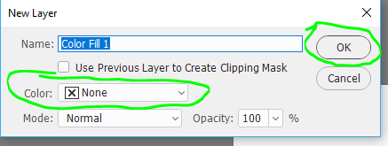

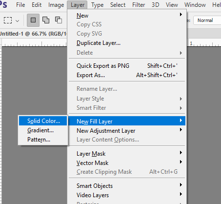

Hi
That menu selection is just to pick the color for the layer panel not for the color area in the image:
You want menu  Layer > New Fill Layer > Solid Color
At the dialogue leave color set at none and click OK
The color picker will open where you can choose white
Dave

Okay. Now the color fill layer I get under Layer>New Fill Layer?
Jun 01, 2017 Jun 01, 2017
Hi
Yes, use Layer - New Fill Layer - Solid Color
Dave
Community Beginner ,
do i check "Use Previous Layer to Create Clipping Mask"?
No, don't check that. As long as you have you selection made then the mask will be added based on the selection.

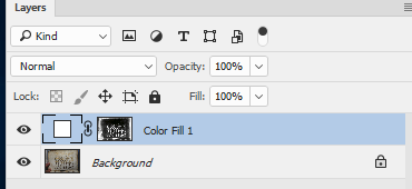

Well. Somehow I've ended up with the exact opposite result! Screen Shot 2017-06-02 at 6.22.25 AM.png
Jun 02, 2017 Jun 02, 2017
The result is visible if you turn off all channels except "Blue copy".
To make that into a separate layer  which is visible at all times:
Add an empty layer at the top
Switch channels so only blue copy is switched on and click on the Load channel as selection icon
The rest of the channels by cicking on RGB
Go to your new empty layer
Edit -Fill - Black
Select - Inverse to invert the selection
Edit Fill White
You will now have a new layer that you can view without switching the channels on and off
I sent you a PM with a link to the PSD file I created when I did the posts above - hopefully it will help you
