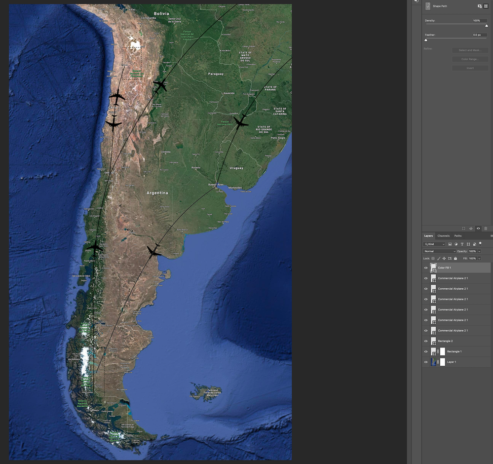

Hello, I tried this but even when the path are now a layer they only when the layer is marked. When I deselect the layer the paths are no longer visible. They disappear when I convert to JPEG. See attached screenshots.
Conrad_C
May 14, 2020
What Fill color and Stroke color/weight settings are applied to the shape layers?
If they disappear when the layer is deselected, that indicates the shape layer might not have a Stroke weight or color applied to it.
(I traveled on some of those airline routes many years ago!)
May 15, 2020
Nice to hear that you have been to these places! I have selected one of the paths and it shows black color and thickness of 3pxls. I have also made sure that all the shapes are brought to the front so that they are not accidentally hidden behind other layer. But the problem is still the same. Screenshot below.
