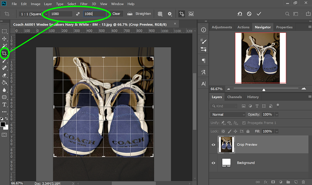

Use the Crop Tool.
Set crop height and width to 1080 x 1080.  See screenshot.
Mar 07, 2021 Mar 07, 2021
If you crop you discard image content. The image has different aspect ratio the image's composition is changed.
