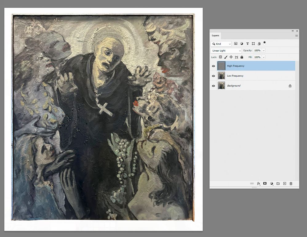

I would use frequency separation. That splits your image into the fine textures (high frequency) and the general colours and tones (low frequency) allowing you to work on each separately. To set this up :
1. Make 2 duplicates of your image layer
Name the lower - "Low frequency"
Name the Higher - "High Frequency"
2. Select the Low frequency layer and use Filter Gaussian Blur (around 6.0)
3. Select the High frequency layer
Go to menu Image > Apply Image
Set the source layer to Low Frequency
Set the blending mode to Subtract
Set Scale to 2 *
Set offset to 128 *
Click OK
4. Change the blending mode of the high frequency layer to Linear Light
5. Now you can clone out the harsh edges of flaked paint on the high frequency layer and restore the colour on the low frequency frequency layer. Remember to set the source for cloning and brush sampling to current layer when working on those separate layers.
* Note - the above steps are for 8 bit/channel images. For 16 bit/channel step 3 changes slightly
Check "Invert" next to channel
Set the blending mode to Add
Set Scale to 2
Set Offset to 0
Click OK
Now carry on with step 4 above
A very quick and dirty example using that technique is below (it deserves much more time and care than this). I mainly cloned on the high frequency layer and brushed with a soft brush on the low frequency layer.
I hope that gets you started.
Dave

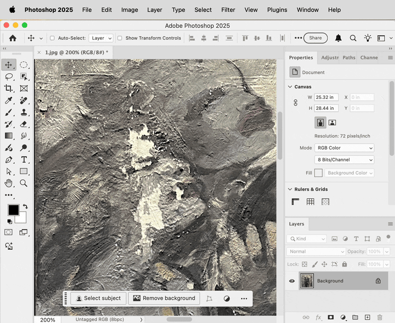

Thank you - that is very kind of you. I have done some digging, but I think what I probably need is a way to replicate brush strokes. I have added a photo here. This one is probably the one with the worst damage. It is very clear to see where the problems are. I have been playing around with different tools, and I have tried using generative AI to see what that could do. It worked pretty well on some parts, but at one point it actually placed a bird into the painting - I had asked it to replicate the surrounding area - I am not quite sure what prompted it to insert a rust brown bird. I am still a PS novice, but working at it every day and slowly learning and improving.

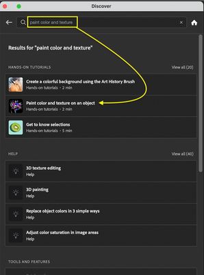

For sure, texture makes this job more difficult. The enormity of the task reduces my pride in my limited abilities. Look for tutorials on turning a photo into a oil painting; this will explore Ps' ability to emulate brush strokes and texture. Here is a tutorial I found via Ps>Help, searched for "paint color and texture," the second tutorial on the Discover interface. (I don't see a hyperlink to copy!)
