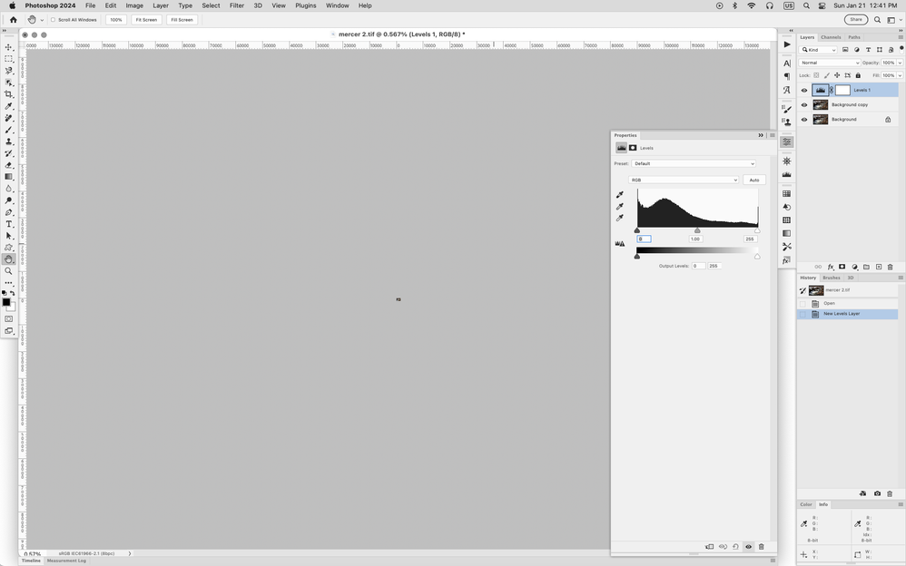

For example, double click on the Levels icon  in the Layers panel.
Can you post a screenshot of what you see after doing that?
The adjustment controls are displayed in the Properties panel when using Layer>New Adjustment Layer
Window>Properties
Layer>New Fill Layer should display floating dialog with the adjustment controls
Fill Layer floating dialog for adjustment controls
Adjustment Layer controls are in the Properties panel

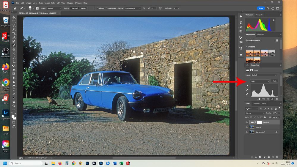

Community Beginner ,
Jan 22, 2024 Jan 22, 2024
This is what I get - i.e. nothing.
You have the Properties panel already showing which is where the adjustment controls are for Adjustment Layers.
If you create a Layer>New Fill Layer, then you should get a floating dialog with the adjustment controls.
Thanks, Jeff, it's the floating dialogue that used to pop up with Create a New fill or adjustment layer > Levels or via Layer > New Adjustment Layer > Levels that's missing.  Unless I'm losing my marbles it also used to appear when I double clicked the adjustment layer icon.  It just doesn't appear any more.
