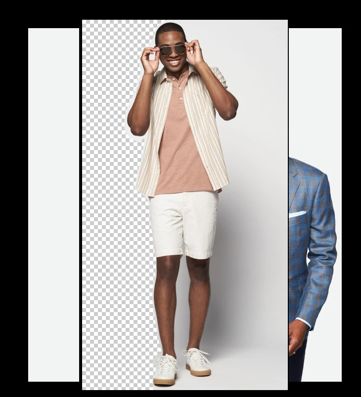

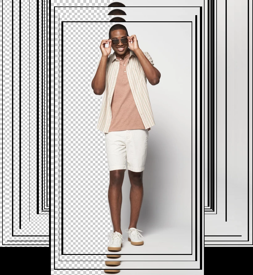

I've searched and searched and haven't found anything related to my issues. Plus, I'm not sure I can actually describe it, but here goes (with screenshots). I have three things going on.
1. Whenever I switch tools when on the same layer, I'm "thrown off" that layer. In other words, I have to select that layer again. Small thing, but collectively time-consuming.
2. If I zoom in or out it does this (see 1st screenshot).
3. And if I switch between two open Photoshop files it does this (see 2nd screenshot).
On both #2 and #3 selecting the selection tool makes it go away. Never had this happen before, and it's driving me nuts. I'd really appreciate any tips. For the record, I have the latest version of Photoshop, and using Mac High Sierra 10.13.6.
Thank you!
Correct answer c.pfaffenbichler
Does turning off »Use Graphics Processor« in the Performance Preferences (Photoshop > Preferences > Performance > Graphic Processor Settings) and restarting Photoshop have any bearing on the issue?

hamiterjAuthor
September 22, 2020
I tried the first suggestion and it worked (turning off "Use Graphics Processor" in Performance Preferences and restarting).
Thank you!
