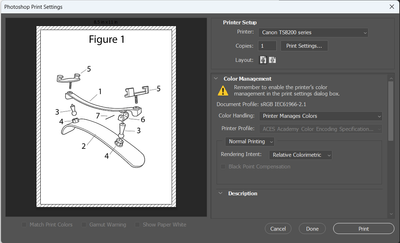

Also, it gives me a yellow caution notice in the print settings dialog. When I click on the "Print Settings..." button, Photoshop crashes/closes.
Aug 30, 2025 Aug 30, 2025
That means the printer driver is crashing. Uninstall-reinstall the printer driver.
(the yellow exclamation mark is just a reminder, not an error.)

Ya, that fixed it....thanks.
I was dragging my feet on doing that because all other apps were printing fine, and sometimes the process of installing the driver software for the wifi printer/scanner can be tedious. It went smoothly this time.
