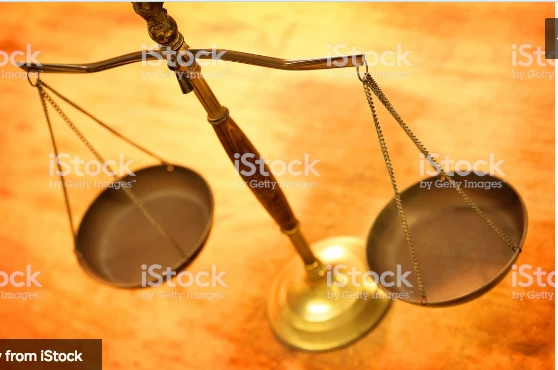

a client is asking to achieve a visual effect with a group of images and i could use some help.
this is the image they like:
and these are the images they want to use:
how would you try to achieve what they want with those 3 images?

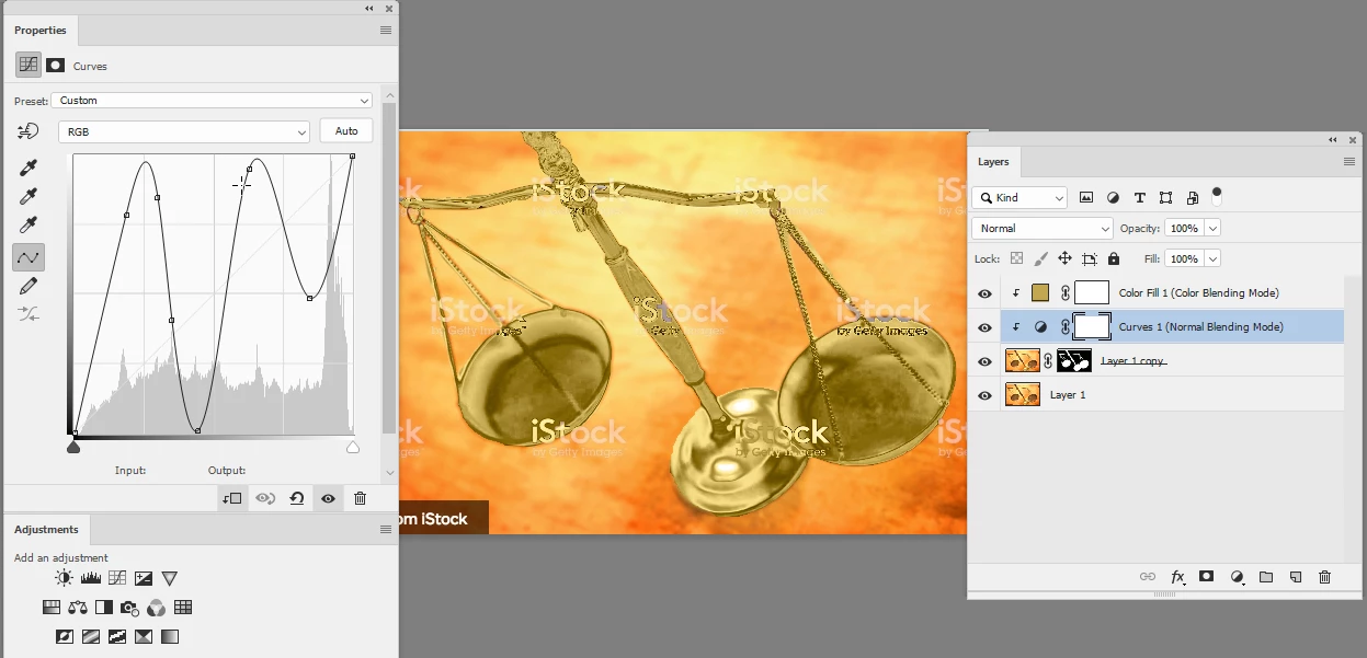

    Correct answer davescm
    Hi
    For the brass look try a curve such as that shown below and a solid color set to blending mode color

    davescmCommunity ExpertCorrect answer
    November 7, 2018
    Hi
    Dave
    Bob_Hallam
    November 7, 2018
    The Brass Effect can be done with Lighting effects.   Start with the 5 lights down and adjust the light colors to white.  Similar to embossing but I like this method.

    yes, i know that part. its the effect on the first image. you see that brass like effect?
