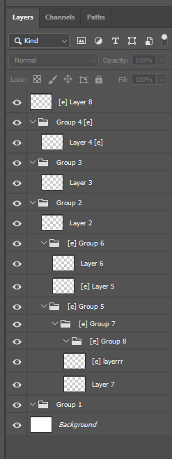

Hi there,
I'm having a hard time figuring out how to iterate through all layers/layer groups, getting alerts to give layer names, checking if layer.name.contains my tag, and more...
My goal is to export "Save for Web" JPEGs by finding layers marked with a tag.
The tag would be inside the layer name (example "[e]" ), though it could be something else.
The images can be nested within many folders, and I need the reference of certain folders to hide them.
The layer structure is usually  layerGroup2> ..... > layerGroup7> layerGroup14> [e] image, image2, etc..
I'm thinking the process would be:
- iterate through all files and folders
- check if name contains tag
- if true, show layer, change export name+path, export, hide layer
- do this untill all images of layerGroup is exported, then hide layerGroup
My script runs right through to the alert "Export Complete". Even though my psd has many layers and layer groups with "[e]" tagged in their name. I'm not sure what I did wrong.
Here's my test psd layer setup:
Note: I come from C# background, this is my first javascript/ps script attempt.
Also I cut off the export function since its very long.

Here are a few things. to go through each layer you need a recursive function or an action manager routine, which is faster, but here's the recursive function:
var doc = activeDocument;
var curLayer
goThroughLayers (doc);
function goThroughLayers(parentLayer){
    for(var i=0;i<parentLayer.layers.length;i++){
        curLayer = parentLayer.layers[i];
        doc.activeLayer = curLayer;
        if(curLayer.typename =='LayerSet'){goThroughLayers (curLayer)}
var curLayer
        else{
            if(curLayer.name=='my layer name'|| curLayer.kind = LayerKind.NORMAL){
                if(curLayer.name.match (/[e]/ig)){alert('match')}
                }//end if
            }//end else
        }//end loop
    }//end function
To create folders on the desktop:
var exportPath(new Folder('~/desktop/folder1);
if(!folder1.exists){folder1.create()};
You can create a loop to go through an array of folder names to create them.

Example of layer enumeration with Action Manager. Subdirectories are formed using the DOM functions (it can be done through Action Manager, but more code is needed). I did not write the export function - it can be taken from the Event Listener, passing the path to the folder and file name as input parameters.
For an best result, you need to check all layers not only by name, but also by type, leaving adjustment layers (if they are located above the desired layer within the same group))
