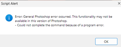

This script worked fine in Photoshop 2020, but now in Photoshop Beta it gives an error. Tell me, please, how can I fix it?
UNFOTONY
July 21, 2023
Yes, strange. Then paste this code at the very beginning of the script that seems to work after the error. The code is surrounded by try-catch and should not raise an error message. But I can't guarantee.

The error will be raised by the last script that runs first. I tried to paste the code into it, but the error still remained. I tried to insert the code into the following script, but the error also remained.
It's strange that the former scripts work well after using the latter.
