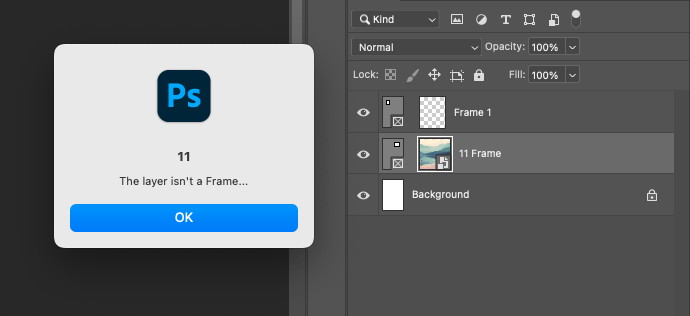

I've been using the 'isFrame' function you provided to check if a layer is a frame type in Photoshop.
After assuming it was functioning correctly for a while, I've recently run into an issue where it consistently returns false for layers that are indeed frame types.
This discovery came as a surprise after a period of usage, as I only now realized the function might not be working as intended. I wonder if there might be a discrepancy in how frame layers are identified or if something has changed in Photoshop's API that affects the function's accuracy.
Would you be willing to take another look at the 'isFrame' function and suggest any modifications?
If there are specific details or examples you need to better understand the issue, I'm ready to provide them.
I appreciate your expertise and any further assistance you can provide to resolve this matter.
Thanks!
Mar 23, 2024 Mar 23, 2024
I may not have the knowledge as this is advanced AM code, but I would be interested to see example files where this fails.
Explorer ,
Mar 24, 2024 Mar 24, 2024
Thank you for your willingness to delve deeper into this issue.
I can definitely provide examples of the layers I've tested the isFrame function with.
To give you a clear picture, I've tried it on various frame layers, including those with images inside and those without any content.
Unfortunately, the function didn’t work as expected in any of these cases, always returning false.
Before I send over these examples, I’m curious—have you had the opportunity to test the function on your end with similar frame layers? And if so, did it perform correctly for you?

Explorer ,
Mar 25, 2024 Mar 25, 2024
The attached file contains two frames: one frame with an image and another frame without an image.
The issue I'm encountering is that the function does not recognize that both elements are frames.
Could you please take a look and advise on any possible adjustments to the function that might help resolve this issue?
Thanks
@Adi1231234 â€“ Apparently it depends on whether the frame or image has focus:
So, I believe that an additional step is required to ensure that the frame and not the image are targeted.
Looking at the AM code recorded when either the frame or the image is selected:
var idselect = stringIDToTypeID( "select" );
    var desc300 = new ActionDescriptor();
    var idnull = stringIDToTypeID( "null" );
        var ref22 = new ActionReference();
        var idlayer = stringIDToTypeID( "layer" );
        ref22.putName( idlayer, "11 Frame" ); // selected by name
    desc300.putReference( idnull, ref22 );
    var idmakeVisible = stringIDToTypeID( "makeVisible" );
    desc300.putBoolean( idmakeVisible, false );
    var idlayerID = stringIDToTypeID( "layerID" );
executeAction( idselect, desc300, DialogModes.NO );
    var desc301 = new ActionDescriptor();
        var ref23 = new ActionReference();
        ref23.putName( idlayer, "11" ); // selected by name
    desc301.putReference( idnull, ref23 );
    desc301.putBoolean( idmakeVisible, false );
executeAction(idselect, desc301, DialogModes.NO);

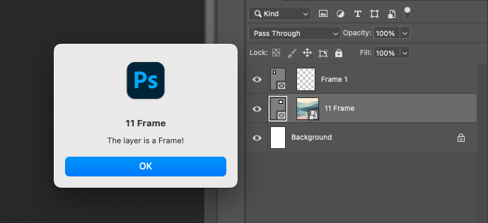

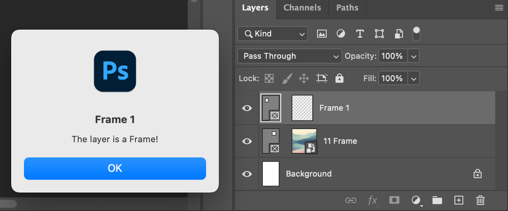

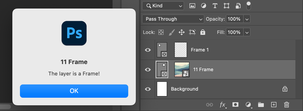

The challenge will be in finding the frame layer name and not the image name in the targeted layer to use with the putName string. Unless there is another way using the layer ID or Index.
Further clues:
This could be a good hack:
app.activeDocument.activeLayer = app.activeDocument.activeLayer.parent;
@Adi1231234
The following is a means to an end (i.e. hack), it forces the frame to be selected if the (smart object) contents of the frame are active:
As Groups, Artboards & Frames are all considered as "layerSets" in DOM code, it takes AM code to truly determine the actual layerSet variant...
Modified from a script by greless with hints from jazz-y!
v1.0, 11th February 2023, Stephen Marsh
v1.1, 26th March 2024 - Added a conditional check to account for the frame content being selected
https://community.adobe.com/t5/photoshop-ecosystem-discussions/custom-script-for-renaming-artboards-with-multiple-elements/m-p/13498536
#target photoshop
if (app.activeDocument.activeLayer.parent.name != app.activeDocument.name) {
    if (app.activeDocument.activeLayer.typename === "LayerSet" && isFrame() === true) {
        alert(app.activeDocument.activeLayer.name + "\r" + "The layer is a Frame!");
        // Do stuff
} else if (app.activeDocument.activeLayer.typename === "LayerSet" && isFrame() === true) {
    // Do stuff {
} else {
    alert(activeDocument.activeLayer.name + "\r" + "The layer isn't a Frame...");
    // Do other stuff

Quite peculiarly, after running the code you shared on the PSD I forwarded previously, it resulted in an alert stating all the layers are not frames. Are you certain this worked for you?
If it worked for you, how is it possible that it doesn't work for me? Could there be differences in the Photoshop versions? Or discrepancies in the execution method? @Stephen Marsh
Mar 30, 2024 Mar 30, 2024
@Adi1231234
I’m not sure, here it is in v2021, File > Scripts > Browse
v2024, File > Scripts > Browse
