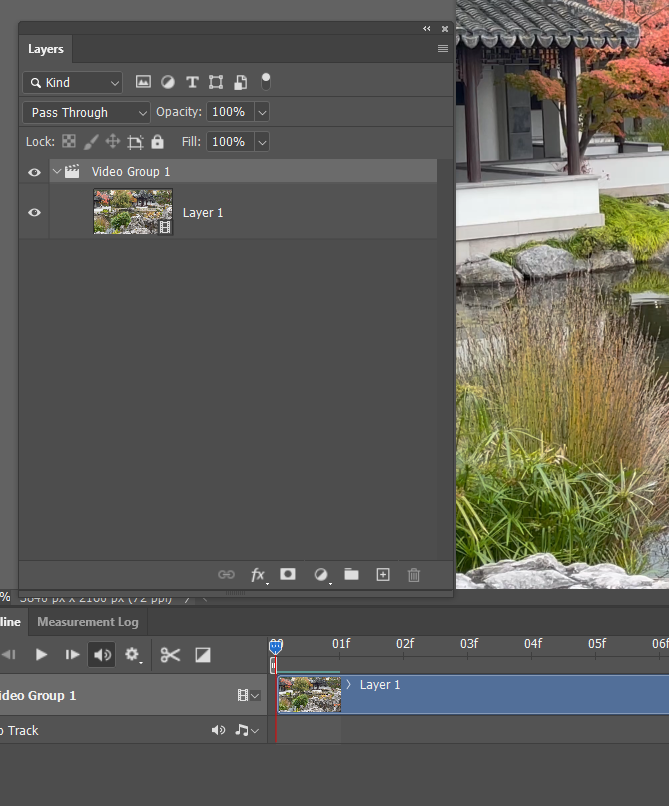

Dave has given you a good answer, and I doubt I can add to it, but I'll try and help with the steps you'll need.  This assumes that the camera does not move — I don't think that even Premiere Pro can track an object that moves in the frame, but After Effects can.
What you need to do is add a patch in a new group, which being higher in the layer stack will cover the video layer beneath it.  So Add a new video group by clicking on the drop down as below
Hold down the Alt (Opt) key and drage the clip in group 1 to group 2 which will place a copy of the clip

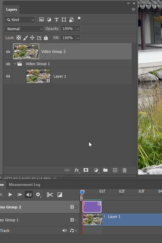

Select the second clip in video group 2, and delete it.  Note you now have just the one clip the layers panel for group 2
You can modify the single frame in group 2, but it is still a video so if you extend it (drag it out) only the first frame will show the edit.  So select group 2 (just the group) and merge it Ctrl E or (Cmd)
Note: You must have the time indicator to the left of the single frame in group 2 before merging it
Video group 2 is now a still image layer, and has become majenta in the timeline (indicating a still image)
You can now make your edit to the still image, and drag it out as far as you need.
But you'll need to hide the unedited area using a layer mask, and feather the mask in maskl properties
