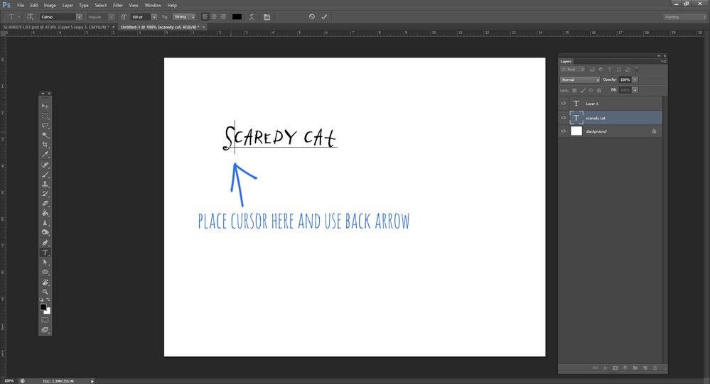

Try placing the cursor just after the first letter in your type layer and using the back arrow to get where you want to be (or the forward arrow, depending), and the type layer instead of a new layer will be the active area:

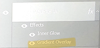

Community Beginner ,
May 16, 2024 May 16, 2024
This shows the FX is on there and layered. But it isnt shoeing up. What am i doing erong?
@Wim.Tosh
Double-click the Gradient Overlay so we can see your settings. Turn off the Inner Glow for now in case it's interfering.
