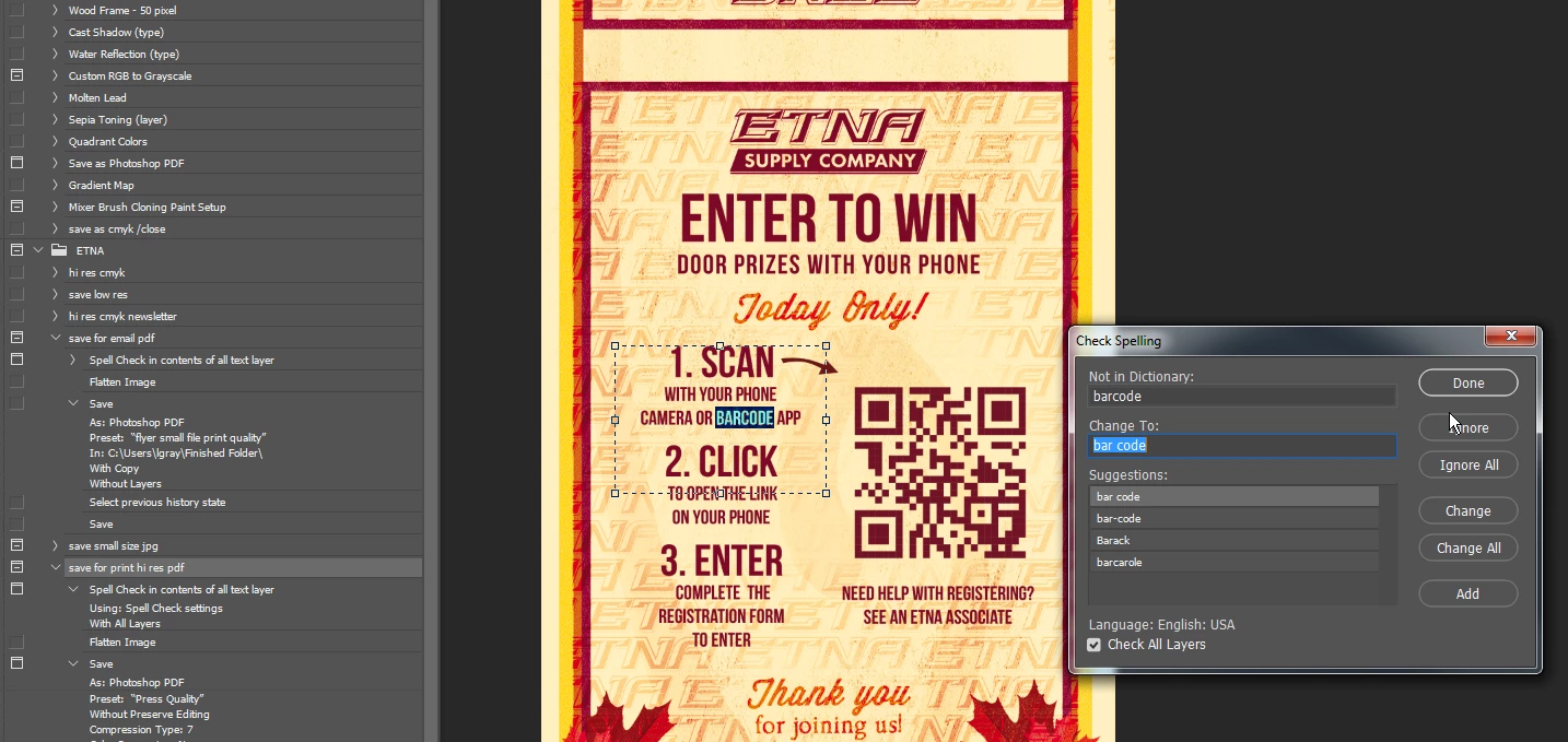

photoshopcc 2019 action with spell check sometimes works and sometimes does not I don't understand why. I took this screen shot then ran a spell check with no problem.

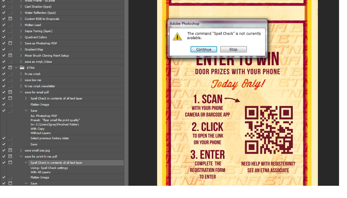

I ran my action in the first screen grab, then ran spell check in the second without any changes. I have used spell check in actions with no problem before but about 1/2 the time the error comes up.  below is my unlocked text layer highlighted, but action spell check does not work.
The bottom 2 are running spell check with no problem, then immediately using action again but it not working.

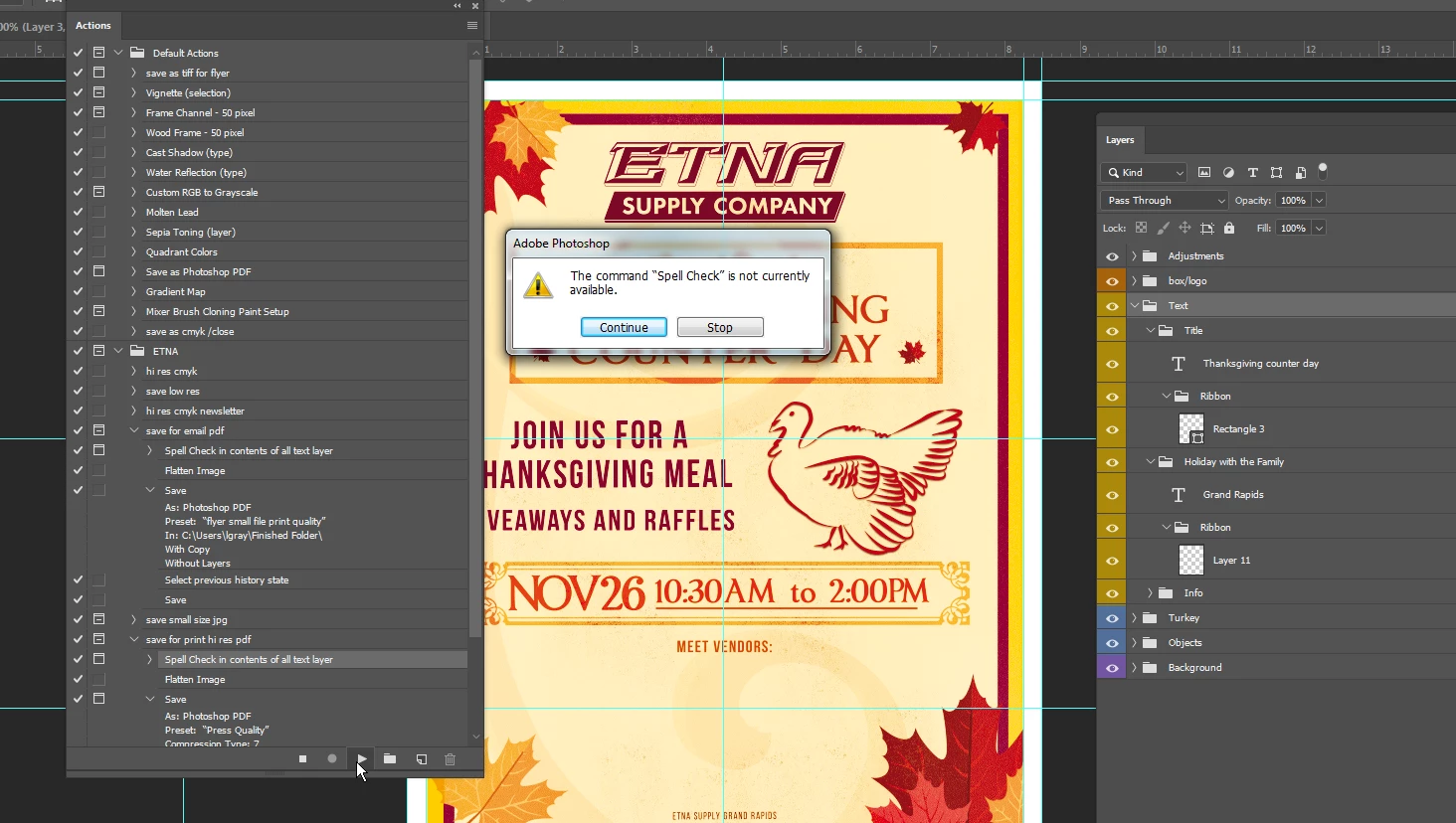

If you click Stop on error, which layer in the document is active at that moment?
Would you show a screenshot of the layer panel at least.
