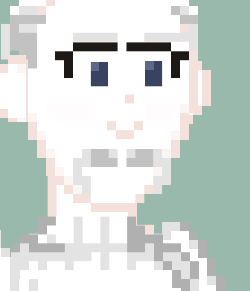

Hi there. I create low resolution pixel art, and I've noticed that when I scale upwards using nearest neighbor, all the layers misalign.
All the layers are linked to one of 5 separate files, they all have layer masks on them too.
I've set nearest neighbor in preferences, on each layer scale preference as well as in the image resize section.
The only thing that may be affecting them is that all the layers have layer masks on top of them, rasterizing each layer first *seems* like it may fix the issue. But I'd like to avoid that because I want to be able to edit the 5 different original files separately. Can anyone help figure out what is happening?

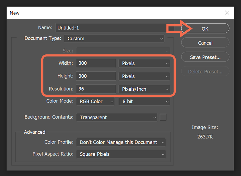

In other words, start with a canvas of normal output size and resolution.
File > New > See screenshot (adjust values as required).

I understand the technicality that 'all photoshop art is pixel art'. However I'm referring to the ultra low resolution style 'pixel art' which is built at ultra low resolutions, and then upscaled by 100-1000% without anti-aliasing in order to be viewed on a normal screen.
Creating a canvas at a normal resolution (1280 x 1280) and scaling up just layers (they are all at 128 x 128) produces exactly the same misaligned effect.
