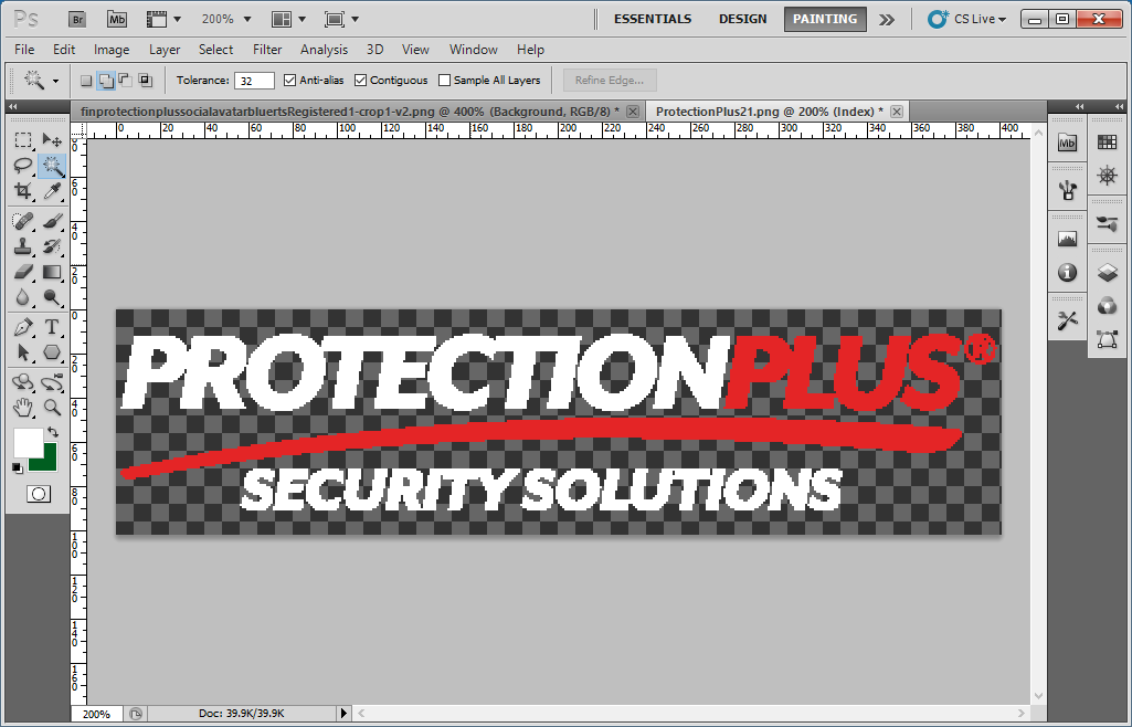

Jul 25, 2019 Jul 25, 2019
Ok, here are screenshots.  The last screenshots I sent were the images opened in Irfanview after saving the file as PNG.  )I combined the before and after into one image.)
Below, I will attach the original image at 200% with the full window in PS.  I found out how to change the default transparency background image.  The pixelation on the red swoosh looks worse with the light background, so I will send that first.  The second image is just after I changed the transparency background to dark.  The third image is after I increased the canvas size (10px on top and bottom).  The quality looks low even before I increased the canvas size, so I don't even know if that's relevant anymore.
The image was only 401x82px to start with, so maybe it's supposed to look bad at 200%.  The bottom line is that the resulting PNG looks worse than the original PNG, outside of Photoshop.
The image is Indexed Color Mode so you probably saved as png-8 instead of png-24.
Anyway: I've had it; there seems to be no screenshot of the original image and what’s so hard about View > 100%?

The original image was a 8 bits/pixel PNG.  I saved the result as 24 bpp.  Could this be the problem?  But the original looked ok.
Oh, when you wrote "View > 100%", maybe you didn't mean "View GREATER THAN 100%".  Maybe you meant ">" as in a menu command.  I could send it as 100%.
