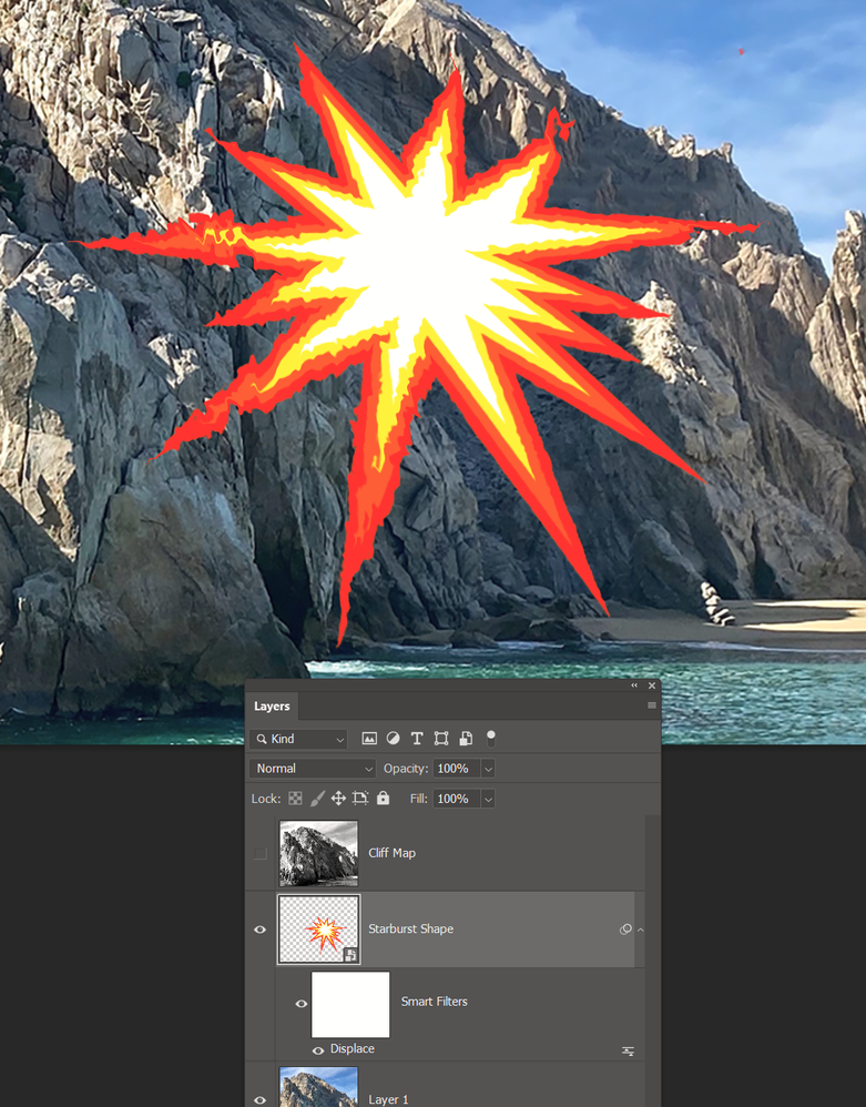

Place your shape and use Free Transform to get the perspective about right
Select the shape layer and go Filter > Distort > Displace
It opens this dialog box. When you hit OK it will ask you to load a map, so find and select Cliff Map
This is actually my second go.  I decided to add Gaussian blur value 2.0 to the map and save it again
I have used a tiny bit of Puppet Warp and ended up with this

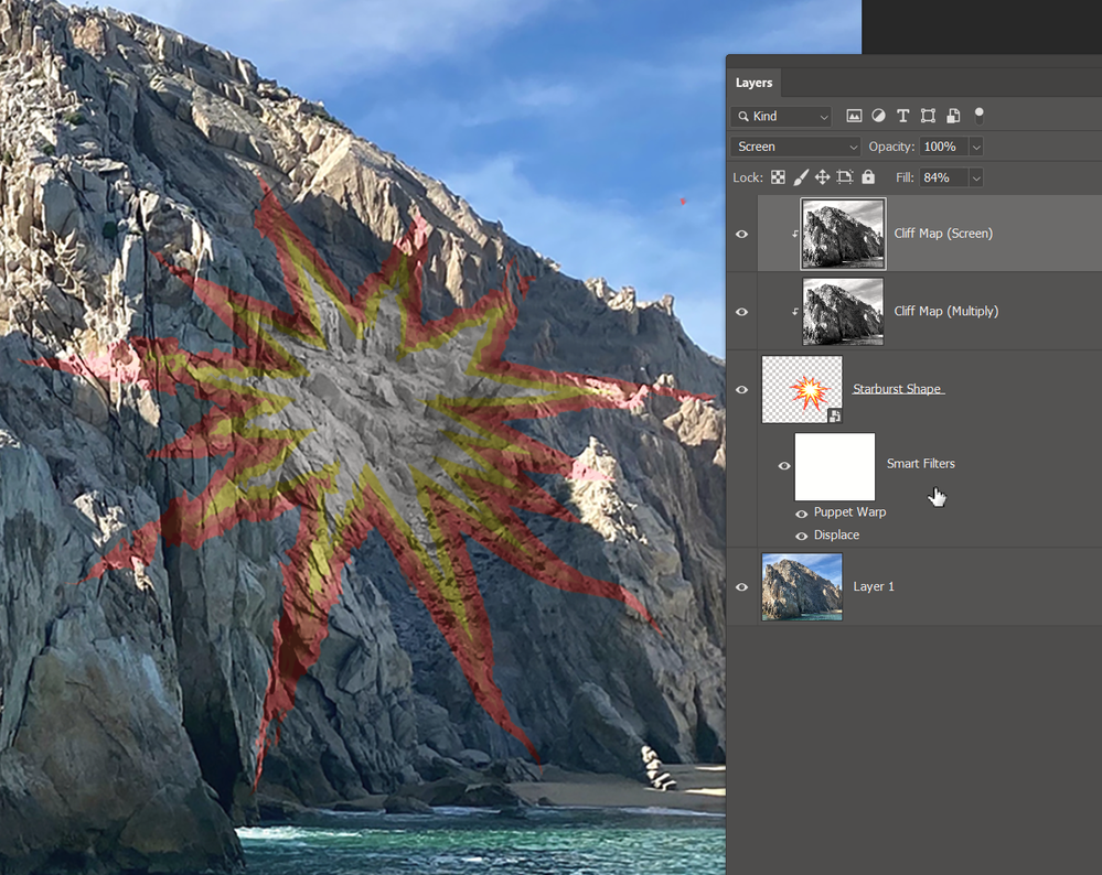

What I like to do is place two copies of the map layer above the displaced layer and clip them to it.
Set one to Multiply, and one to screen, and adjust opacity to suit.  This gives us some shading, but we lose some contrast.

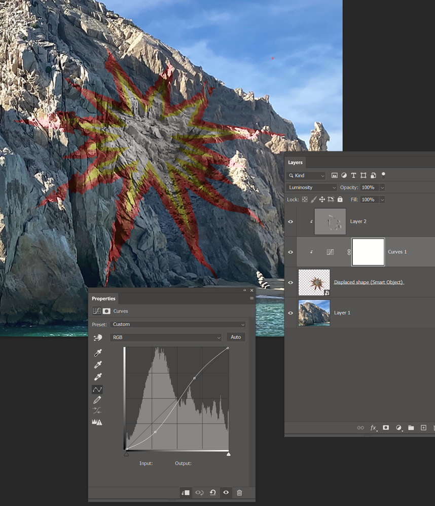

So to finish off, I've combined the displaced shape and the two shading layers as a Smart Object.
I have clipped a curves layer to that SO and given it some contrast.
Last of all I have clipped a 50% grey layer set to Overlay, and used dodge and burn (or a low opacity black or white brush) to reinfoce shadows and highlights.  It took me much longer to type this than to do it, so you'll be able to make a way better job if you take more time over it.
