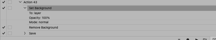

Myra Ferguson
March 15, 2023
If the images are all JPEGs, you could record an action where you unlock the background layer and use the Quick Action in the Properties panel to Remove Background. Then you could batch process them (File > Automate > Batch...) and select your action to run.
