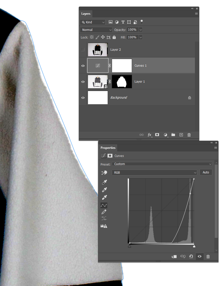

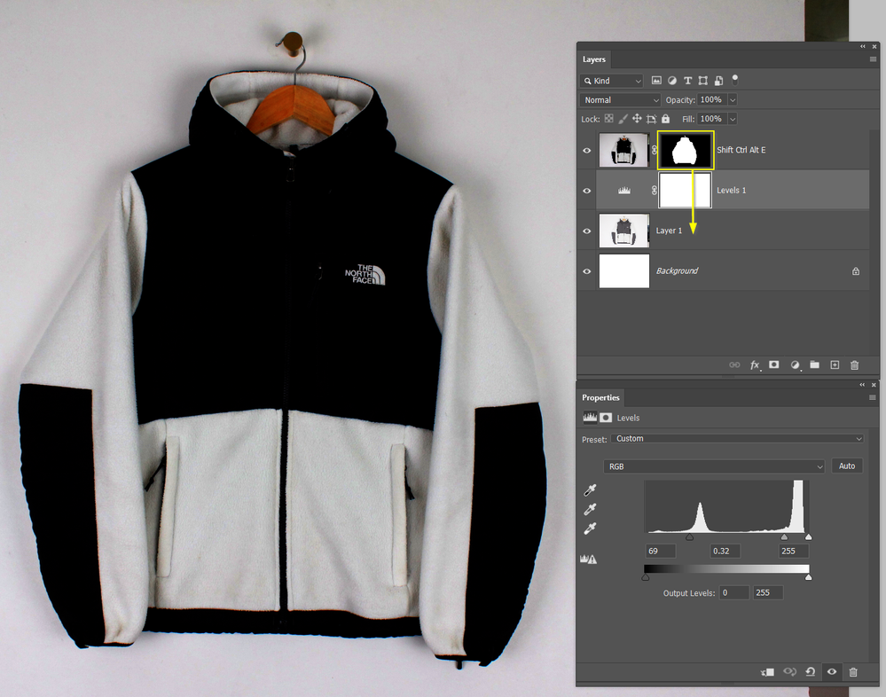

What you can do in this situation is fiix the contrast with Curves or Levels.
Send a copy merged layer to the top of the stack, and use Remove Background on that layer.
Drag the resulting layer mask back to the original layer, and delete the contrast fixing layers.
OK, full disclosure.  I did again with a curves layer, and decided to test the resulting mask maunally using a clipping path, and Remove background has missed a bit of the sleeve. 😞
You can see there is bugger all difference in the with and without curves tonal values.
But there was even less with the original image, so you are really up against it.  It would almost certainly have been better with a coloured jacket, as even with the highlights so close to clipping, you probably have at least one channel with good contrast.
What it usually comes down to with tricky situations is that we have to accept this has no one click solution, so you do your best with whatever selection method works best, and choose to save as a layer mask.  You can then use other tools, like a clipping mask to edit the layer mask.  Especially true when you have organic soft outlines, and hard straight and gentle curves on the same object.

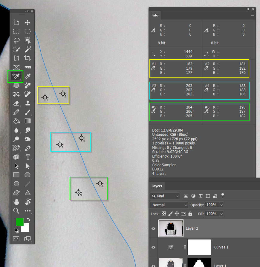

I don't think you could do this without some manual input because of how close the sleeve and background are to each other in the problem area.  If you used a Curves layer and click on the little hand icon (Magenta highlight) you can them move the cursor, and see its tonal value reflected on the curve (red highlight).  You can then click to create a point on the curve at the required position, and use it to drag down and make darker.
We can also see a simple histogram behind the curve.  Left to right indicates tonal value, with highlights on the right, but you will have already known this. The hight of any spikes on the histogram, indicates how much content the image has of a particular tonal value.  We can see an empy area right at the top of the curve, so we can clip the highlights by draging the (green highlight) point to the left to the far right of the spike.  You can then drag the magenta highlighted point down to give you your best chance of fixing the contrast because you have targeted the edit points.
This would be close to an optimised fix 'for that area on the sleeve' but it will have made already darker tones possibly too dark for good result with Remove Background at other areas on the jacket.+
Hmmm...  Well it actually did OK everywhere else, but still missed a bunch of pixels in the problem area.

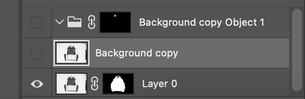

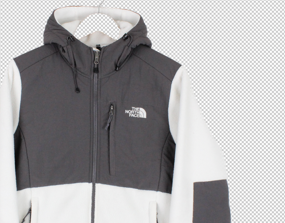

Following on from my last message. I was playing around with things and I selected 'Mask all objects' in the layer panel and it gave me a PERFECT line of the object. I have no idea why it's done this. I'm just trying to figure out how to make this into an action. It also gave me 2 random masks. I'll attach photos.
Screenshot 2024-03-12 at 18.34.48.pngScreenshot 2024-03-12 at 18.34.44.pngScreenshot 2024-03-12 at 18.34.33.png
