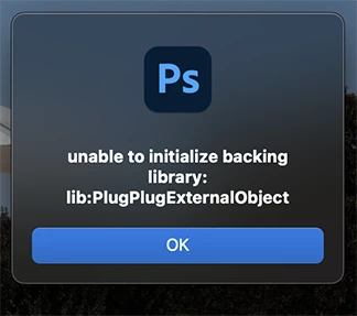

Hello everyone
I am writing to you because I need help.
I am a user of Creativ Caloud and I use two computers for my work (Mac OS - one with M1 Max, the other with intel processor).
I also installed Adobe Photoshop 2023 on both computers a few hours ago.
On the Mac M1 Max, immediately after installing Adobe photoshop, a problem appeared: constantly and from the beginning this "notification" appears
"Unable to initialize backing library: lib:PlugPlugExternalObject".
It also didn't copy all the plug-ins.
I must point out that this problem only appeared on the M1 Max computer.
On another computer (intel processor) Adobe photoshop works fine, everything works and also all plug-ins were downloaded without problems.
I had this problem on my M1 Max computer for the first time..until now everything was working fine.
I am kindly asking for your advice and help on how to solve this problem
All the best
Joe
Correct answer RysUp
Here's the fix for this:
Here is the solution, posted by another user (Matt) in another forum.  Much easier & faster than restoring all preferences, settings, etc.  Its just this one strange file:
  • (macOS) Users/<user name>/Library/Preferences/Adobe Photoshop <target_version> Settings
  • Inside that folder, look for "tw0001.dat" and delete it or rename it to tw0001.dat.OLD (it's used for some old extension that is no longer required)
RysUpCorrect answer

November 10, 2022
Try removing Photoshop with the CC App and reinstalling it from scratch.

November 17, 2022
Perhaps try resetting Photoshop preferences?
(read this entire post before acting please)
Resetting restores Photoshop's internal preferences, which are saved when Photoshop closes.
If they become corrupt then various issues can occur.
Here’s some info on how to do that:
https://helpx.adobe.com/photoshop/using/preferences.html
Manually removing preferences files is the most complete method for restoring Photoshop to its default state:
https://helpx.adobe.com/photoshop/using/preferences.html#Manually
Note re macOS: The user Library folder is hidden by default.
To access files in the hidden user Library folder, see here for how to access hidden user library files.
https://helpx.adobe.com/x-productkb/global/access-hidden-user-library-files.html
Unexpected behavior may indicate damaged preferences. Restoring preferences to their default settings is a good idea when trying to troubleshoot unexpected behaviors in Photoshop. check out the video
https://helpx.adobe.com/photoshop/using/preferences.html#reset_preferences
Learn how to access and modify Photoshop preferences and customize per your frequent workflows
And here’s an earlier forum discussion as an aid to understanding
https://community.adobe.com/t5/photoshop-ecosystem-discussions/quick-tips-how-to-reset-photoshop-preferences/td-p/12502668
You may want to backup your settings and custom presets, brushes & actions before restoring Photoshop's preferences.
Here is general info about that:  https://helpx.adobe.com/photoshop/using/preferences.html#BackupPhotoshoppreferences
Before you reset your preferences
in case of future issues, I suggest you make a copy as Adobe may need one to check problematic references.
Quit Photoshop.
Go to Photoshop's Preferences folder
Preferences file locations: https://helpx.adobe.com/photoshop/kb/preference-file-names-locations-photoshop.html\
  [on MacOS see: Users/[user name]/Library/Preferences/Adobe Photoshop [version] Settings
  Note for those on macOS: - be aware that the user Library folder is hidden by default on macOS.
  In the Finder, open the “Go” menu whilst holding down the Option (Alt) key.
  Library will now appear in the list - below the current user's “home” directory. ]
Now you can drag the entire Adobe Photoshop [Version] Settings folder to the desktop or somewhere safe as a back-up of your settings.
Preference preservation is affected by macOS permissions,
you’ll need to allow Photoshop ‘Full Disk Access’ in your Mac OS Preferences/Security and Privacy
It may even be time to reinstall Photoshop.
It’s recommended that you use the Adobe CC cleaner tool to remove all traces first.
(See above about preserving preferences though! Its worth preserving them unless they are corrupted.)
https://helpx.adobe.com/creative-cloud/kb/cc-cleaner-tool-installation-problems.html
Uninstall Photoshop BUT make sure to choose the option “Yes, remove app preference”.
Once that process finishes, start the installation process and look into the “Advanced Options”. Uncheck “Import previous settings and preferences” and choose to “Remove old versions”.
I hope this helps
neil barstow, colourmanagement net :: adobe forum volunteer
