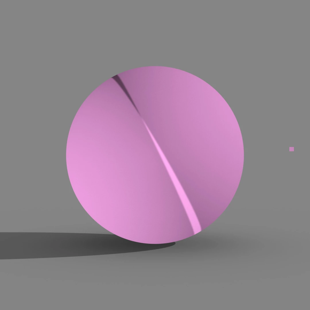

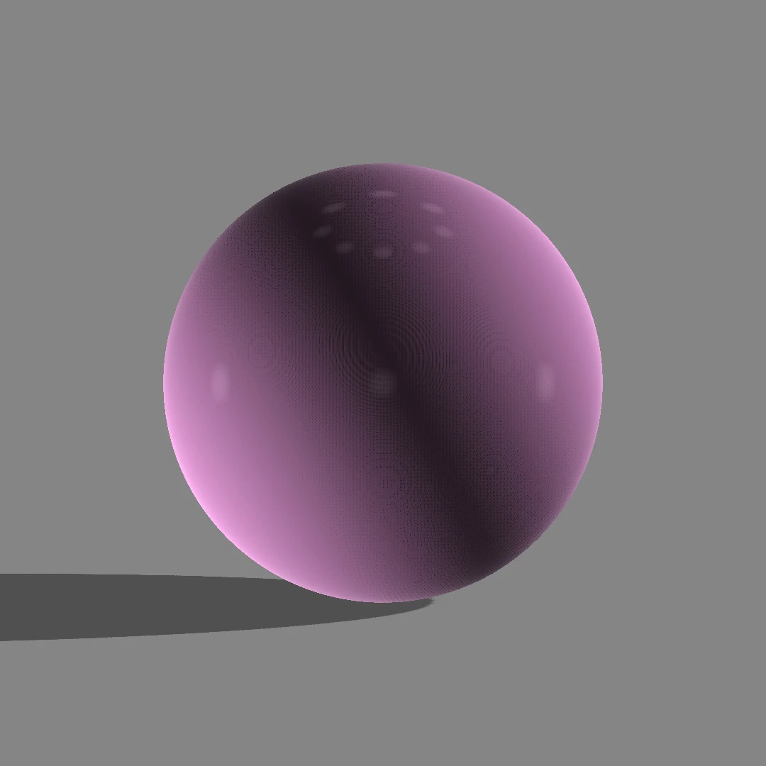

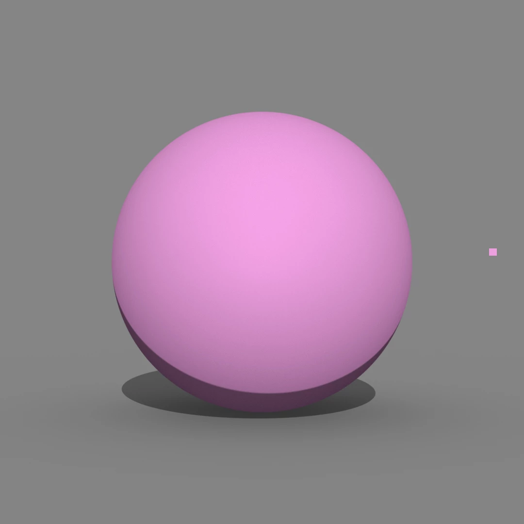

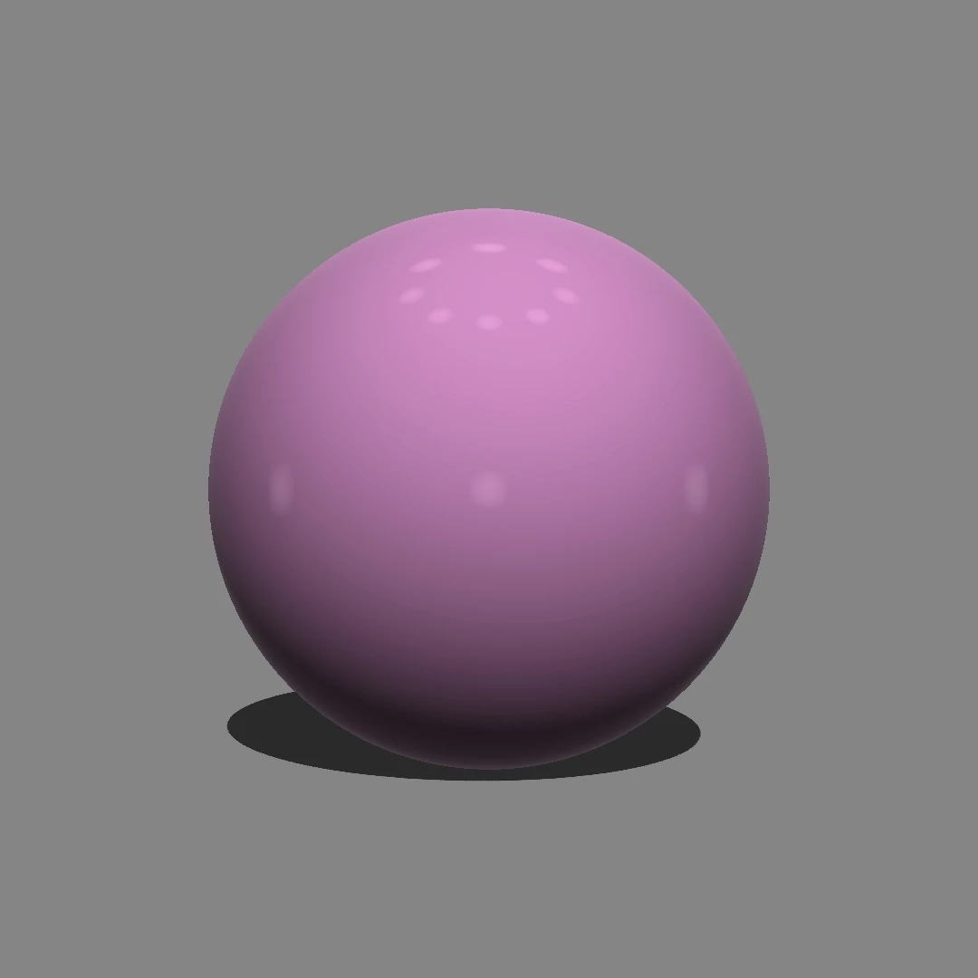

Hi, I work with Photoshop 2020 (the latest version) on iMac 21,5 inch - Late 2012, processor 2,7 GHz Intel Core i5 quad-core, graphic card NVIDIA GeForce GT 640M 512 MB and RAM 16 GB 1600 MHz DDR3.
I’ve some problems with the 3D rendering: the final result at the end of the rendering is very bad, the look is different and there are some little square out of place.
I’ve attached some files as examples before and after the rendering process, files 1 (sphere) before and after, files 2 (sphere) before and after.
Could someone help me? Thank you!

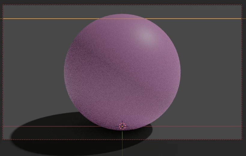

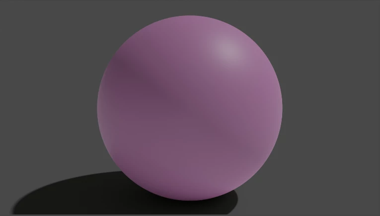

I exported your model to Blender and got the following :
Preview :
Render :
So the issue appears to be with Photoshop
Preview :
Render :
