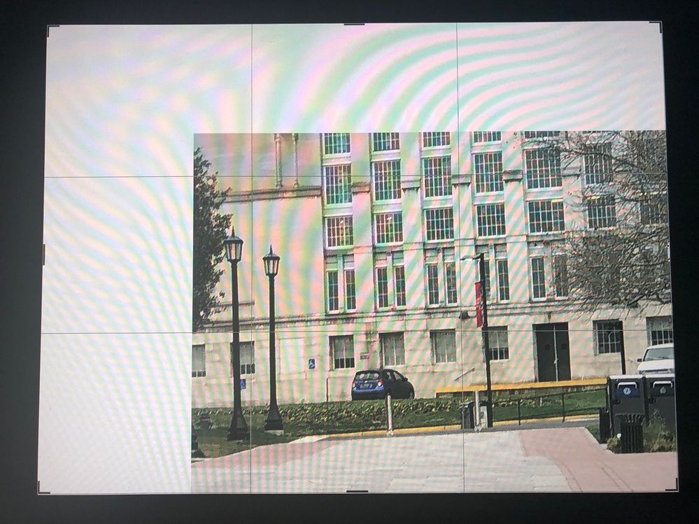

Hey, there:

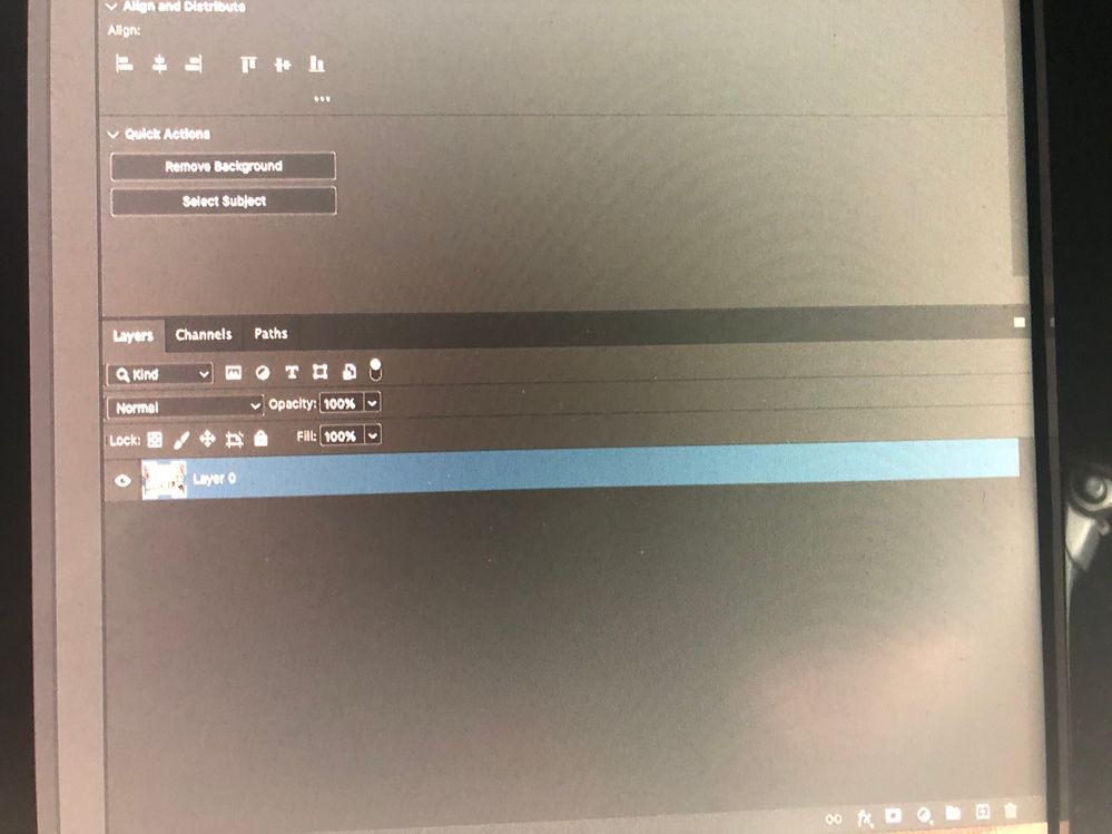

I am going through Julianne Kost's excellent into to Photoshop 2020 on Linkedin.  I am quite sure I am following what she says to add a tansparent layer to the canvas.  I hit the lock icon on the background in the Layers panel and I get a layer, just like in the video.  Then I click in the image to set the crop and then drag out while pressing opt+shift, the checkerboard pattern should appear.  Instead, I get what looks like white background.  What am I doing wrong?
Thanks.
Kenneth

It could be that the transparency setting in your preferences is set not to show the checkerboard pattern.

That's interesting because I haven't touched preferences. It should be "factory settings."  But it sounds like a reasonable suggestion so I will try that.   Thanks very much.

Thanks--under preferences, Grid-size, it said, "none."  I chose a different size and  one appeared.  Will try the exercise again later.
May 23, 2020 May 23, 2020
If it's set to none, your background will be white.
Hello, in the option bar of the crop tool, uncheck "Delete Cropped Pixels", or Photoshop temporarily creates a white background layer (check your layers panel as you use the crop tool)
(that also means that you will have a larger file than expected when cropping down, and that you can go back and "un-crop")
