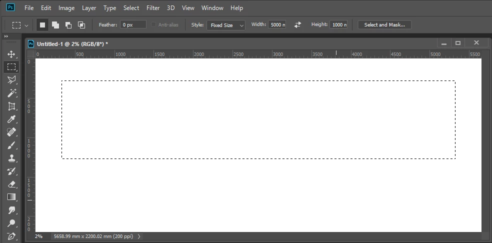

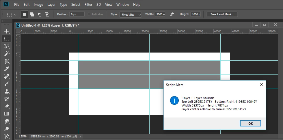

    Do you have to create the rectangle with the rectangle tool?   The rectangular marquee tool does not have that limit. You could add an empty layer meke a seletion and fill the selection to make the layer rge size you need.
