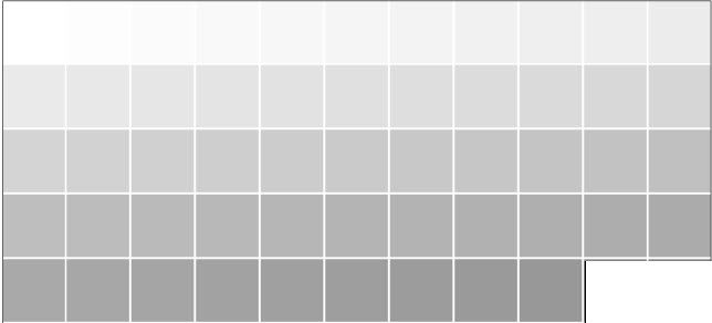

My document has a Gray Gamma 2.2 profile. The image consists of 53 cells arranged left-to-right and top-to-bottom (like English text). The first cell (at the upper left) has an RGB value of 255 and the last cell (at the lower right) has an RGB value of 151. Each cell is 2 RGB units darker than the previous cell : 255, 253, 251, ..., 153, 151.
I want to normlize this image to have a full tonal range from white to black. In other words, I want the first cell to remain white, the last cell to become black, and the intermediate tones to be evenly distributed over the range 0 to 255.
Using a Curves adjustment layer, I set the black point on the last cell. But instead of setting its RGB value to 0, it sets the value to 1:
Clearly there's something I don't understand about black point. I always thought black was 0.
Why does this happen, and what should I be doing? It is essential for my application that the last cell have an RGB value of 0.

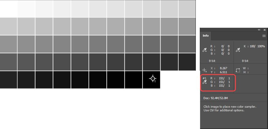

I'm convinced it's a numerical problem that has nothing to do with the document profile. In the grid I attached, each cell is 5 RGB units darker than the previous cell. If I use a grid with the same number of steps, but where each cell is 3 units darker than the previous cell, setting the black point on the last cell makes that cell (0,0,0). The result is the same regardless of the document profile.

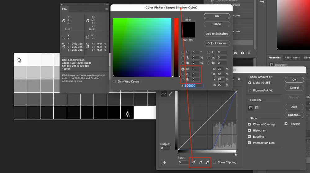

For photographic editing, setting the endpoint is usually done at a less than full black value and the tonal range is set in the relative darkest part of the photo with detail, as opposed to the absolute darkest part. So perhaps your values are not set to 0r0g0b? Although this screenshot uses curves, it is also available using levels, double-click the eyedropper.

I tried several ways of doing it, all with the same result. In fact, the first way I tried was using a curve adjustment and sliding the Black Input over to 151, just as you did in your screenshot.  But wait, I see you used 152.  Sure, that will give you black in the last step, but the tone won't be evenly distributed. 0, 3, 8, 13, 18, ...
By masking black over the last cell, I localized the non-linearity: 0, 6,11,16,21.
Even if there's no clean way to fix it, I would like to understand why Photoshop does this.
