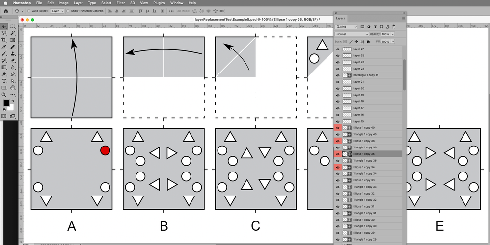

A relatively simple question but I'm struggling to find a sensible way to do it. Any help would be much appreciated.
I have lots of images, hundreds in fact, similar to the attached. I would like to swap the circles, each of which is an individual layer, with another image (a square).
Crazy utopia: some magical way to batch process this based on layer name
Real world hope: Is there a way to select a load of layers (e.g. all the circles) and then tell Photoshop to replace all of those layers with a particular image, presumably duplicated across the layers?
So that an image goes from this
To this

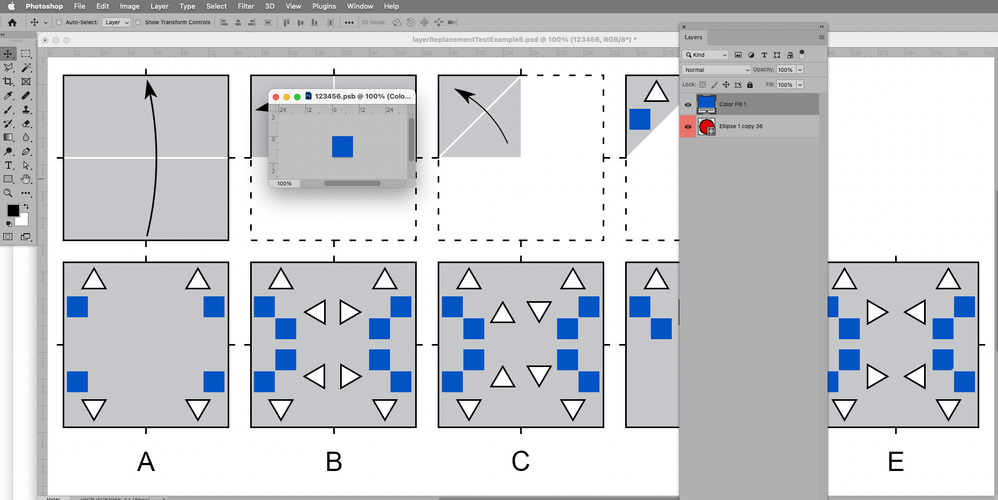

It is possible to change the Shape Layers of (practically) identical Vector Masks to the selected Shape Layer, even if rotated and flipped, to instances of one Smart Object via Script.
Once that is done one can easily change all the instances in one go (see screenshot 3).
But transfering the rotation and flipping to those SO-instances would seem like a bother, so it only would make sense for, in this case, the circles and squares.

Thank you Trevor. Unfortunately there are hundres of images, each one with circles in rnadom places, that all need replacing with squares (or turning into squares, the are ellipses, if there is an action to turn every ellipse into a square, that would achieve the same thing.)
I'm uploading a PSD file here as requested previously. In this example, figure A has been manually changed to the result I am looking for, and the old ellipse layers are simply switched off.  I have about 300 files like this, and I'm hoping to turn every small ellipse into a small square.
