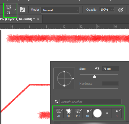

Hi Alexia.  I have just tried this with current release and beta versions, and it is working as it should.  I can only think that something has broken in your situation, and much as I hate to go straight in with a reset Preferences suggestion, I can't think what else could cause the behaviour you are seeing.   You could maybe try resetting the tool rather than Preferences as a first try.
I take it you can see the size in the Recent presets strip as well as the Option bar?

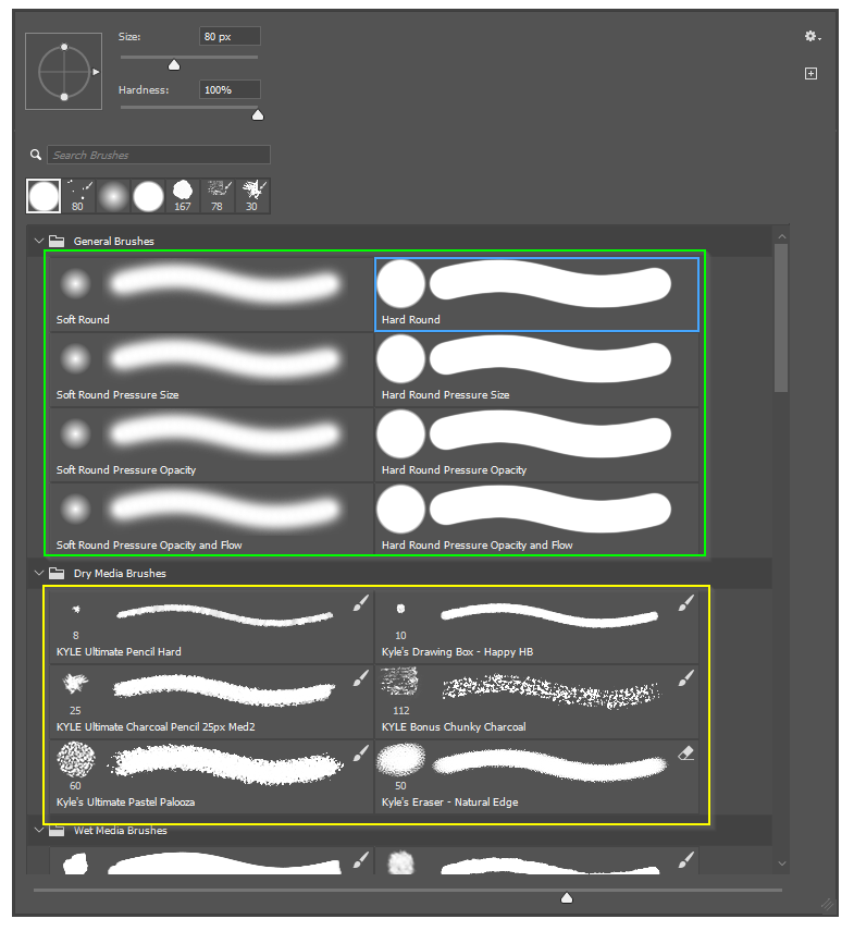

I thought about this some more.  AFAICT if the preset has a size in the Brush panel then it will work the way you want it to.
If no size is shown, as in the presets I highlighted below, then if you resize them, select another brush, and select the first brush from Recent brushes, its gone back to it's original size.  Give that a try.  It's late here and I am out of time, but that's the way it seems to work.

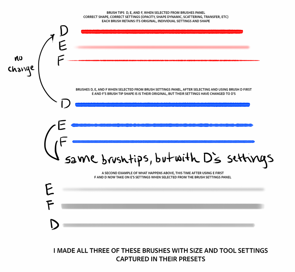

Hi Trevor, thank you for the response. I've tried to make a visual description of the issue. My drop down menu looks different than yours for some reason, but hopefully that isn't an issue.
As I've said, I tried resetting the tool already. Several times now to no effect. I reset all my preferences and then reimported my workspace.
Normally I don't use the options bar to switch between brushes or adjust them, it is far quicker for me to use the Brushes tab/panel. Within the Brushes panel and the brush tool options drop down, there are no corresponding size numbers to each brush. However, I do not want a brush to return to a default size whenever I switch to it. That would be just as counterproductive.
The red lines diagram refers to what happens to each brush when I select it from brush settings. Doing so does revert it to its default size. The blue lines diagram refers to what happens when I switch from brush to brush by using either the general list or the recents strip.

I've found out something very absurd. After I use a brush that I selected from Brushes, D in this example, and use it, it goes to the top of of my Recents bar as you would expect. If I continue selecting from Brushes, everything behaves normally.
However, when I go to Brush Settings to switch to E or F (etc.) after using D, E and F change to their preset sizes, but their settings are replaced with D'S. They look and behave completely unlike they are supposed to. This is also the case when I select them fromthe Recents bar.
I have a hunch that this is related to the problem of the Recents Strip in general not remembering the size of a brush during the last state it was used in.
