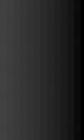

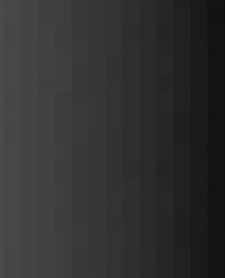

Hi all, just found weird thing about copying layer pixels to a layer mask.
I have simple gradiend (made by Gradient Tool), that looks good, but when I select it, copy, and paste these exact pixels to a layer mask, I get this weird pixels. Applying gradient with Gradient Tool right to the mask looks perfect like in the source layer.
Any ideas what's happening here and how can I copy a layer to a mask without losing quality?
Correct answer D Fosse
Apparently you're working in 8 bit color depth, which is limited to 256 discrete steps between black and white.
The layer mask will be represented in your working gray. The default working gray (dot gain) will have a very different tone curve than any standard RGB tone curve - especially in the shadows. In this conversion, banding can easily get exaggerated with multiple numerical steps between each band.
Try to set working gray to a grayscale profile more similar to whatever RGB color space you're working with, like e.g. Gray Gamma 2.2. That should reduce the banding. Working in 16 bit depth there shouldn't be a problem.

Wow, thank you! Changing working gray to sGray completely solved my problem.

Hi @YoshiSugiyama both your examples look the same and not smooth. They both appear to be banded gradients.

August 11, 2023
There are a few slightly different pixels in each band, which seem to be enhanced by the copying. Maybe turning off Dither in the Gradient options might help?
