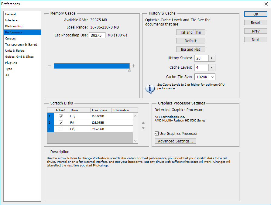

Well, followed that work around to the letter/number, apart from entering 8192 like you said (instead 8196 as in the workaround) then set Base as Decimal as instructed, resulting in 33,170 and now Photoshop shows 30,375 MB as available RAM, which of course is nonsense. It is a DWORD (32-bit) Value I should be adding in? 64 bit Windows 10 and 64 bit Photoshop CS6 I'm running. PS I don't normally set the usage to 100%, just did when it was only 3,336MB available. That update has come since start of last week then heathert36881419 ? Pretty sure I looked in Preference/Performance then and all was normal.

The exact problem is that at the start of last week Available Memory to Photoshop (within the dialogue box I just posted) was much closer to the 8GB that I have installed. A few days ago I realised that it was only 3,337MB.
Trying that workaround, as described above, has now resulted in ridiculous "Available RAM" figures.
As I said earlier, I was not getting that Error message, but it was suggested that I still try the Workaround.

However...if I set Base as Decimal first and then enter in 8192...now I'm getting something more like the old setting in the Memory Usage settings of Preferences/Performance...Available RAM: 7479 MB
Of course if I had more knowledge of registry editing I'd probably have spotted that mistake straight away...but I do not, as perhaps many people do not who will follow that workaround that was perhaps written a little hastily by the person who misplaced their calculator as you wrote earlier 🙂
Well, at least it looks more normal now. I'll see how it performs with this current big file.
