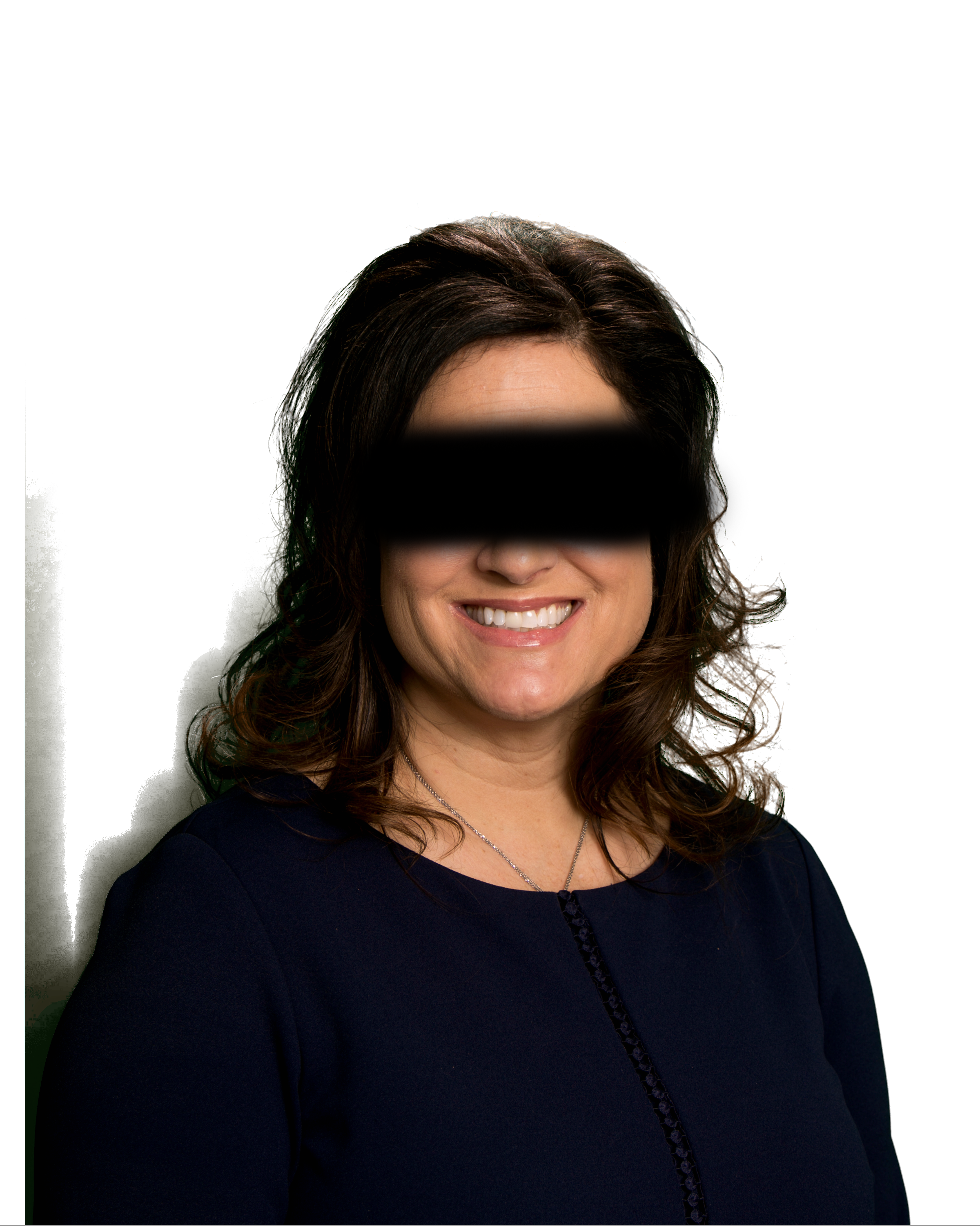

When I take this image into "select and mask", it selects everything ok but when I try to erase the black shadows on the left from the background with the "refine edge" tool, it does absolutely nothing! What am I missing here??

The background is too similar in color to the subject. Refine edge is struggling to define where the subject’s edge is. You will have to paint this section manually. The third tool down in select and mask is a regular brush. You can paint over the background with the brush set to minus, and that will erase the background.

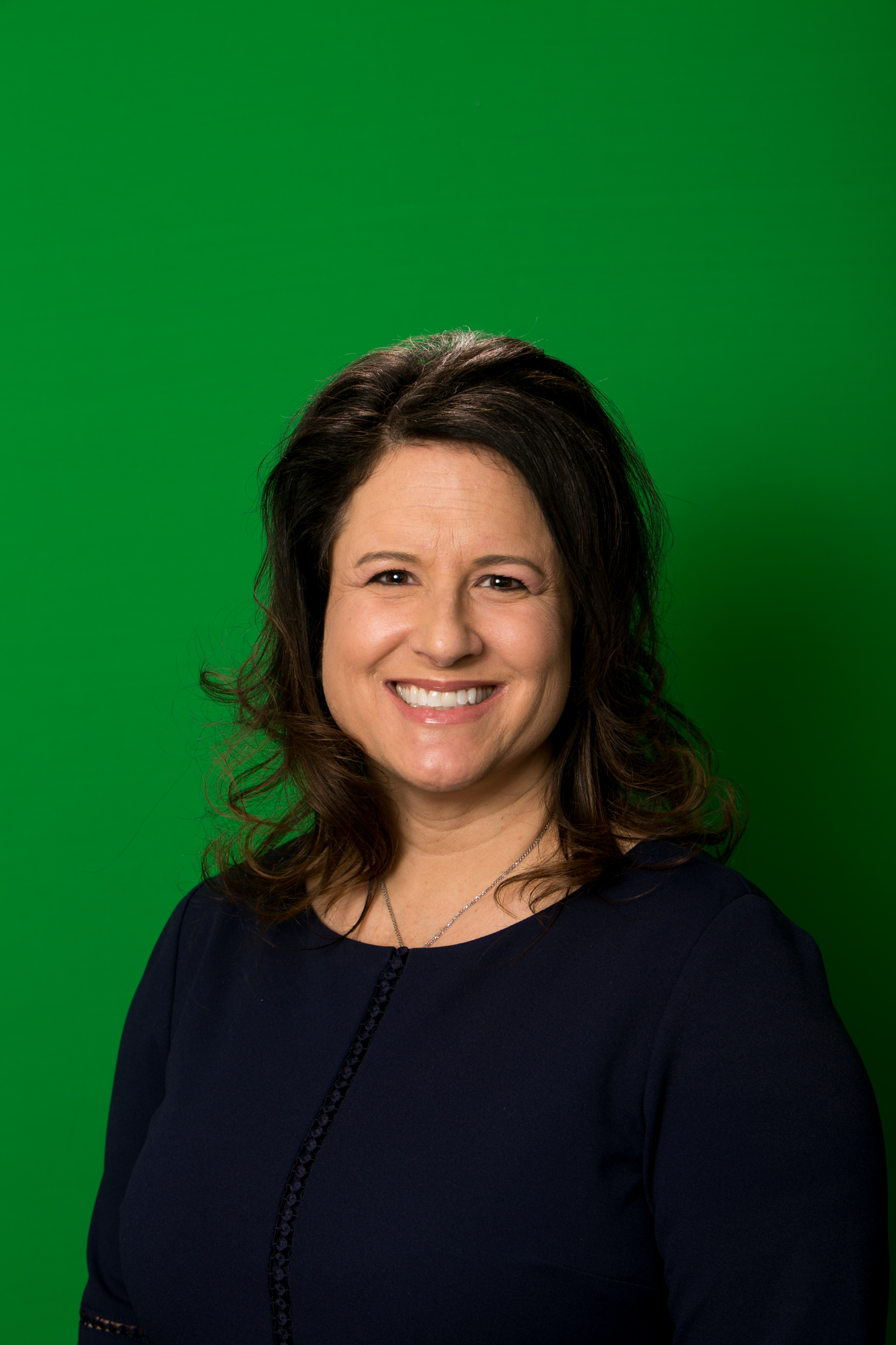

With that tool, it would be impossible to get the hair looking natural, since it's transparent in areas. I am enclosing another photo with the original green screen showing. I can't select and mask this one either. What am I missing here? This should be easy with the newest refine edge tool in cc!!!!

It sounds like you are using the wrong approach. The easiest way to do this is by first selecting the woman with the Quick Selection brush. Then go into 'Select and Mask' and expand the selection to include the hair. It took me less than two minutes to get this:

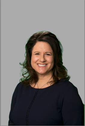

Hi and thanks for your detailed reply. This looks pretty good overall, but
the area of the hair on her right shoulder ended up being blocked up a bit
instead of showing the transparent areas (originally green). It looks like
you put this on a grey background. My output would actually be on a
transparent background and saved as a png for compositing

You can put it on any background. I usually mask against a similar background as the intended use, as I would finish differently for use on black as I would on white. Fine hair is semi transparent. The transparency checkerboard is not ideal as it hides some details. Once done just turn off the plane background.
