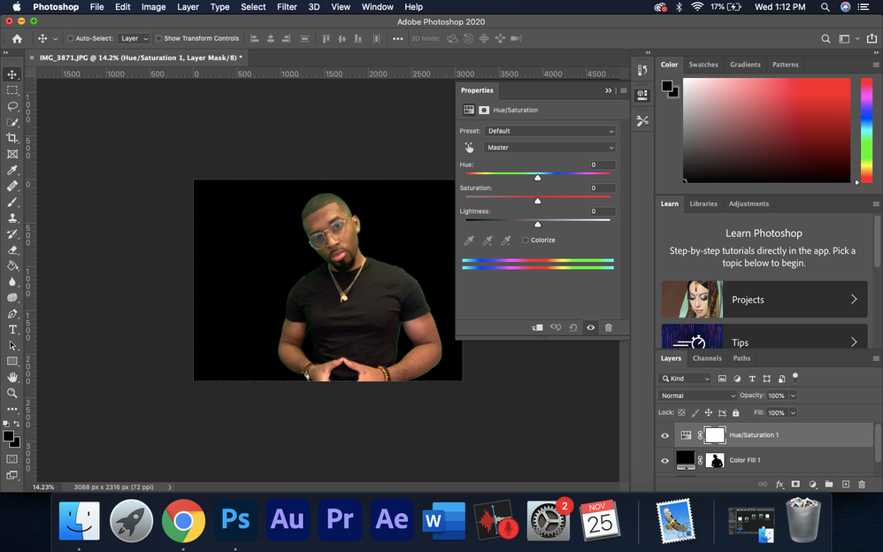

Débutant dans la communauté ,
Nov 25, 2020 Nov 25, 2020

I think you should restructure your file’s Layers.
Putting the background behind the clipped photograph is not technically necessary but I think it helps with more intuitivelly processing the stack of layers.
As per @davescm  ’s advice you can then Clipping Mask a Color-Layer to the Layer.
If some edges seem too bright additional touch-up on another Clipping Masked Layer could prove useful.

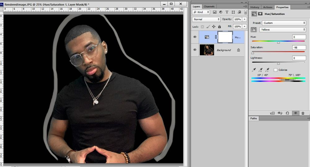

Hue-Saturation layer. Lower the saturation of yellow and green.

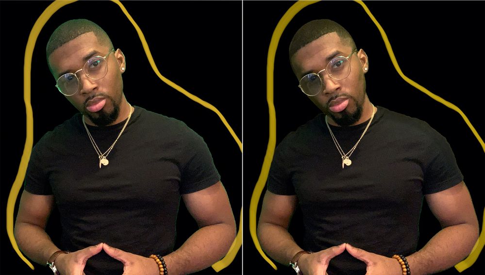

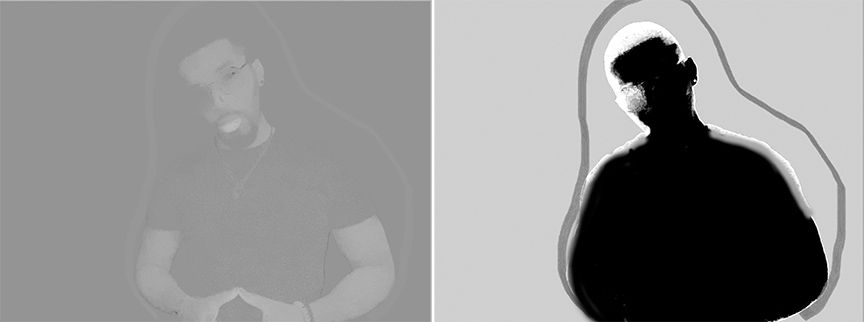

You may consider using Lab Color as an alternative. In the sample above:
1. Change the image to Lab Color Mode and add a duplicate layer
2. Go to Channels, choose the  a  channel where green is represented by a dark value and magenta is shown as a light value.
3. Create an Alpha channel from the  a  channel and paint as shown. Use Curves and a brush to increase the contrast and paint out areas where the green tone in the image is not to be affected.  Then invert the result. It is the mask.
4. Return to Levels and add the mask to the top image
5. Choose Curves and in the  a  channel bisect the grid horizonally. Move to the Lightness channel and, after moving from the mask to the image prt of the layer, with the hair as a reference, darken the shadow end of the curve. (I may have overdone the darkening. See this in larger size.  Easy correction,)
6. Return to RGB Mode

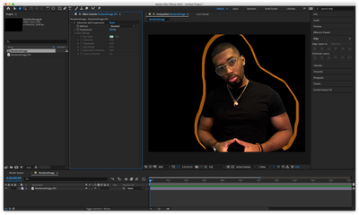

If your Creative Cloud subscription includes After Effects, you can import the image into an After Effects project to apply Keylight to the original image, assuming that you still have it with the green background.  Then apply Advanced Spill Suppressor to remove the green spill from your image.
If the green from the original image has been deleted, you can still apply Advanced Spill Suppressor.
Keylight can be found under Effects > Keying > Keylight (1.2).
Advanced Spill Suppressor can be found under Effects > Keying >Advancd Spill Suppressor.
To return to Photoshop, choose Composition > Save Frame As > Photoshop Layers...
It's usually a good idea to save the After Effects project in case you need to return for further adjustments, but you don't need to if you're happy with the results when you're back in Photoshop.
