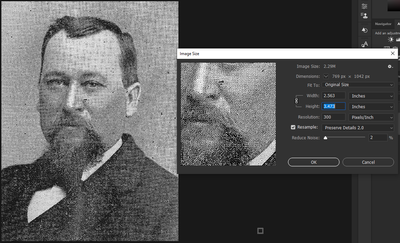

Is there a way to remove "lines" from a photo taken of a newspaper (I think) portrait? I believe my wife shot a newsprint picture and I would like to clear up all the clutter so we can use them in a book. We have permission to use these photos.
4.6K
Adobe
Jun 18, 2022 Jun 18, 2022

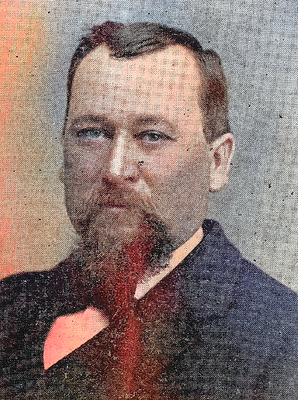

Hi @Northporter, Sure, it can be done, but not instantly. Is your attachment the only file you have to work with, or is there a larger file? This one would only be able to print (if it's a print book) at a size of about 2.5 x 3.5 inches. I colorized it to see where the most work needs to be done, which is in the beard, suit, and forehead. It's easy to select the subject and replace the background with a neutral gray or anything else. If you still have the newspaper, a better way to go might be to scan the sheet at a high resolution, so you have something better to start with. Then, it's going to be rebuilding the various areas using a variety of tools.

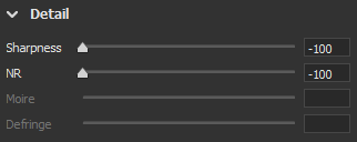

Removing Moire in Photoshop/Camera Raw
Advocate ,
Slider is greyed out, so I suspect it's for color moiré only.
Or I'm doing something wrong, or it is not really moiré.
If the slider worked, I suspect it would still be useless on the original.
It's a good one for Neural Filters someday...
Slider becomes active on the colorized version, but seems indeed useless here...
