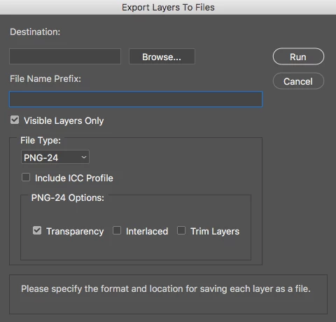

When I want to use the "export layers to files" function in Photoshop, there's always a prefix of the layer number sequence. For example, I'll export a number of layers (to pngs) and the prefix is _0001, _0002, _0003... I don't think this feature necessary in most cases. I already removed the standard 'File Name Prefix' in this dialog box. But, that doesn't hold true after export. Is there a way to quickly remove this default script?
Or if not possible, is there any recommendations on advance 'file renaming tools' like GREP in InDesign?
Correct answer FrankDraws
For Photoshop CC 2018 go to:
Applications/Adobe Photoshop CC 2018/Presets/Scripts/Layer Comps To Files.jsx
Once you open the file, go to line 209 and comment it out.
I've attached an image for reference.
Once I did this, Photoshop stopped adding the sequence number prefix to when I export Layer Comps To Files.

FrankDrawsCorrect answer
December 8, 2017
May 7, 2020
This is great, thanks for the tip! Was able to apply this same method on 'Export Files to Layers' removing the starting has marks.
Here is the code to remove the hash for that jsx file. Change 'fileNamePrefix' to layerName, see attached CC 19
