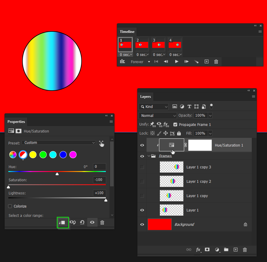

If this is a frame animation, then each frame has a layer.  You can place an adjustment later above those layers, and affect every layer/frame beneath it.  Or you can place some of those layers in a group, and clip an Adjustment layer to that group.
In the example below I have four frames of a rainbow layer style that goes red to red.
Note that the background is also red.
I have grouped the layers and placed a Hue/Saturation layer above that group, and clipped it to the group (the icon I have
I have grouped the layers and placed a Hue/Saturation layer above that group, and clipped it to the group (the icon I have placed the green highlight around.
In the properties panel for the Hue/Sat adjustment layer I have selected the reds, and moved saturation to zero, and lightness to max.  That has made the reds in the animation frames show as white, but the red background is unaffected.
