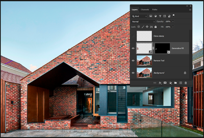

I used the remove tool to remove a bunch of things from this brick house.
Removal does not have to be perfect, but it does such a nice job a first time effort is goona be pretty nice.

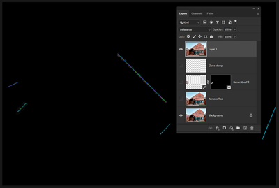

First Remove Tool
Second Generative Fill
Third
Clone Stamp
Fourthly
All edited elements in Difference mode
Do you have any examples of your own?
I think the picture has been ‘chewed over’ enough now.
