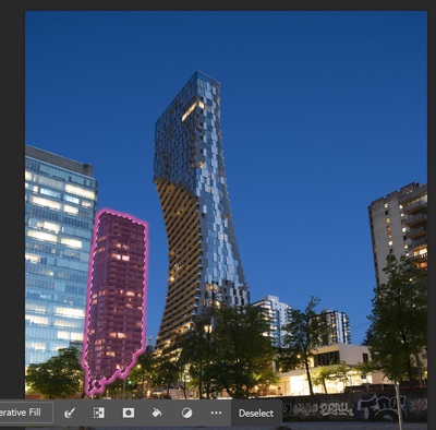

I am trying to remove a building from a picture using the Generative Fill, Patch and Clone Stamp tools, as seen in the images below.
Below is the selection of the object I want to remove:
When I use Generative Fill and instruct it to replace the building with "blue sky" thisis the best result:
When I use the Patch Tool I get this result which trying to partch from the right side of the tall tower:
I also tried the Clone Stamp by sampling the sky to the right of the builidng but it was not very satisfying either:
What is the best tool to use for this type of editing?
Thanks!

May 12, 2024 May 12, 2024
I wouldn’t recommend focusing on Generative Fill alone but the result I get does not seem that bad.

Explorer ,
THanks.  I used Generative Fill but had less success witht he colour matching, for some strange reason.  I also used Content-Aware Fill and got a similar result:
I'm not sure why the colour is so consistently off. When I sued content-Awre Fill I sampled the colour immediately above the slection, and got a much darker patch, which I'm now trying to lighten.
Thanks for your help!

May 13, 2024 May 13, 2024
Below are screen shots of my entire process. I stuck with Content Aware Fill - in previous attempts it seemd to be a better colour match.
This is an enlarged version of the previous image.
Thanks again for your asssistance!
May 18, 2024 May 18, 2024
I cannot discern the Sampling Area.
Please try the Remove Tool and Generative Fill.
Explorer ,
Unfortunately the sampling area disappered from the screen when I hit Windows-Screenshot to capture my desktop. THe sampling area was directly above the artea to be replaced, in oroder to get the best colour match.
May 19, 2024 May 19, 2024
That would not seem like a great sampling area as you need content for the lower parts, too.
