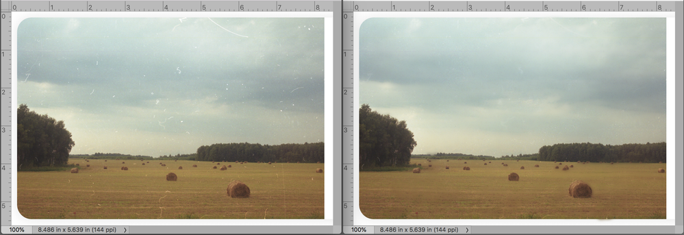

I know I am a little late to the party but I am adding it in the event you find this technique useful.
  1. Open the file
  2. Cmd+J to create a duplicate layer
  3. Filter > Blur > Gaussian Blur. Blur until the specks disappear
  4. History Panel. Move the History Brush symbol down to Gaussian Blur step
  5. History Panel. Choose the layer above the Gaussian Blur step. The specked version will reappear.
  6. Choose the History Brush Tool (soft edged) and in its Options bar change the Mode to Darken
  7. Paint the dust specks. You don’t need tiny brush and you may find, depending upon the subject, you can drag the brush
