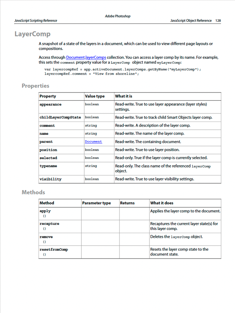

You need to address the LayerComps instead of the Layers then.

According to the documentation the name of a LayerComp is read-write, so what is the problem?

var comps = comp.LayerComp;
That’s not correctly written, please look at the screenshots I posted.
var comps = comp.layerComps;

Aug 01, 2022 Aug 01, 2022
Why did you capitalize the first letter?
I did not write
var comps = comp.LayerComps;
(edited)
Please forgive my harsh tone, JavaScript is case-sensitive and that may take some getting used to.
It makes a difference if one writes »LayerComps« or »layerComps«.

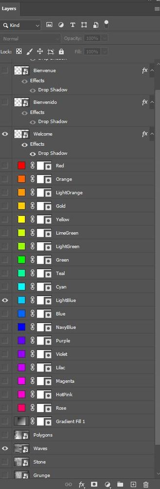

Community Beginner ,
Oct 05, 2023 Oct 05, 2023
Is there anyway to update this script to Comp Layer names to be the visible layer for each comp?
The script I'm using just changes the names to whichever layer i have selected when I run the script:
Could you please post screenshots with the pertinent Panels (Toolbar, Layers, Options Bar, …) visible to clarify what you mean?
Oct 06, 2023 Oct 06, 2023
I created a few hundred layer comps based on visibility combinations of layers only, using text layers, color layers, and background image layers.
Please post meaningful screenshots that actually illustrate the relation of the names of Layer Comps and visible Layers …
