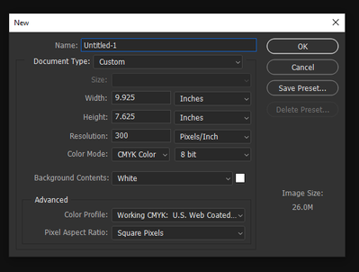

Okay, here is what I would do. Create a new document with an 1/8 inch bleed at 300 dpi (7.625 x 9.925 inches). File > Place your image on that canvas. Scale the image to fit in that space as you like. Add the text you want. Save as a JPG file and submit to the publisher.
Note: the CMYK to RGB will depend on what the publisher wants so you may need to convert your image file to CMYK or create your new document as RGB.
 If you add a .125 bleed, the measurements would be 7.625 x 9.925 inches.

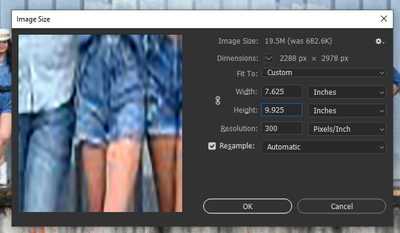

Something's wrong here. Those pixel dimensions are much too high for a magazine page. And where did 72 ppi come from? That can't be the correct print size.
As I said above: You need 2250 x 2940 pixels. Plus bleed. That's 7.5 x 9.8 inches at a standard magazine print resolution of 300 ppi.
Photoshop doesn't really work with sizes; it works with pixels only. The size is given by the pixels per inch number (ppi). Repeat that to yourself: pixels per inch. Those three words give the whole game away. The file has a certain number of pixels, and the ppi number determines the size.
In this case the ppi number is 300, and at the required physical print size, the pixel dimensions are given.

I think the pixels and resolution in @alcord_24's screenshot is their original photo size. If you add a .125 bleed, the measurements would be 7.625 x 9.925 inches. This is what that aspect ratio looks like on the full image when cropped H or V.  Inches converted to pixels at 300 resolution are below.
