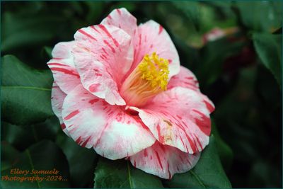

Thank you for responding. I understand how to remove the background. My problem is how do I add a solid color? Here is an example of a photo I want to do this with.

It can be as simple as adding a Solid Color fill layer and putting it behind the object layer. I like using Solid Color fill layers because it’s easy to change the color if needed.
The demo below shows these steps. First, the background removal, and I am going to use Select and Mask because I don’t think it’s enough to just cut it out due to the green color fringe:
1. Choose Select > Select and Mask.
2. Click Select Subject. This selects the subject, but the flower has a green color fringe because of color spill from the background.
3. In Global Refinements, adjust the Radius value. This is one thing that helps remove the color fringe.
4. In Output Settings, select Decontaminate Colors. This also helps remove the color fringe.
5. Set Output To to New Layer With Layer Mask, for maximum flexibility. Then click OK.
OK, that was the background removal part. Now for the solid color, the really easy and fast part:
6. In the Layers panel, click the Create New Fill Or Adjustment Layer button, and choose Solid Color. Set the color, and click OK. Stack it behind the flower layer. To adjust the color, double-click the Solid Color fill layer. That button is a shortcut for choosing the menu command Layer > New Fill Layer > Solid Color.
