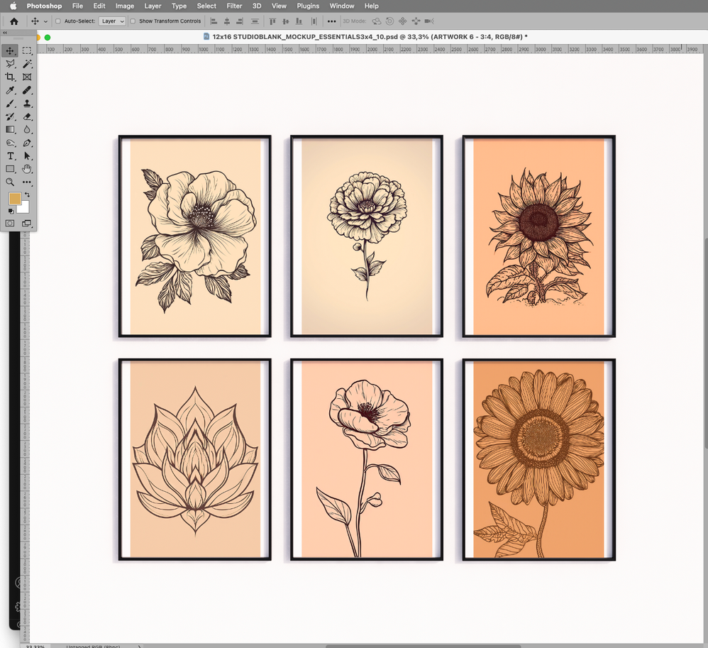

Hi, I need a Photoshop script for my Wallaart mockup PSD files. I summarise the necessary steps for you below.
  1. The script will work from my previously opened PSD file
  2. there are 6 smart objects in PSD file
  3. In the input folder, there are 6 jpg image files.
  4. The script will go through this input folder and place these inside of 6 smart objects.
  5. As images and smart objects are of different sizes, there needs to be resizing of images by Width should be increased by 112,3% and height should be increased by 112,3%..
  6. I've uploaded a screenshot of my PSD file.
    thank you
    Note: I've read almost all topics regarding Replacing Multiple Smart Objects via Script but I couldn't find any solution for this.

What is the naming-convention for the replacement images and their relation to the Smart Objects in the template?
Sam-90Author
May 9, 2023
Okay lets say that before start these process first I have adjusted the dimensions of the photos to the same size as the smart objects in which they will be placed.
Now what? I've tried to write some code but as I'm not good at javascript, I can't find the problem in the code.
