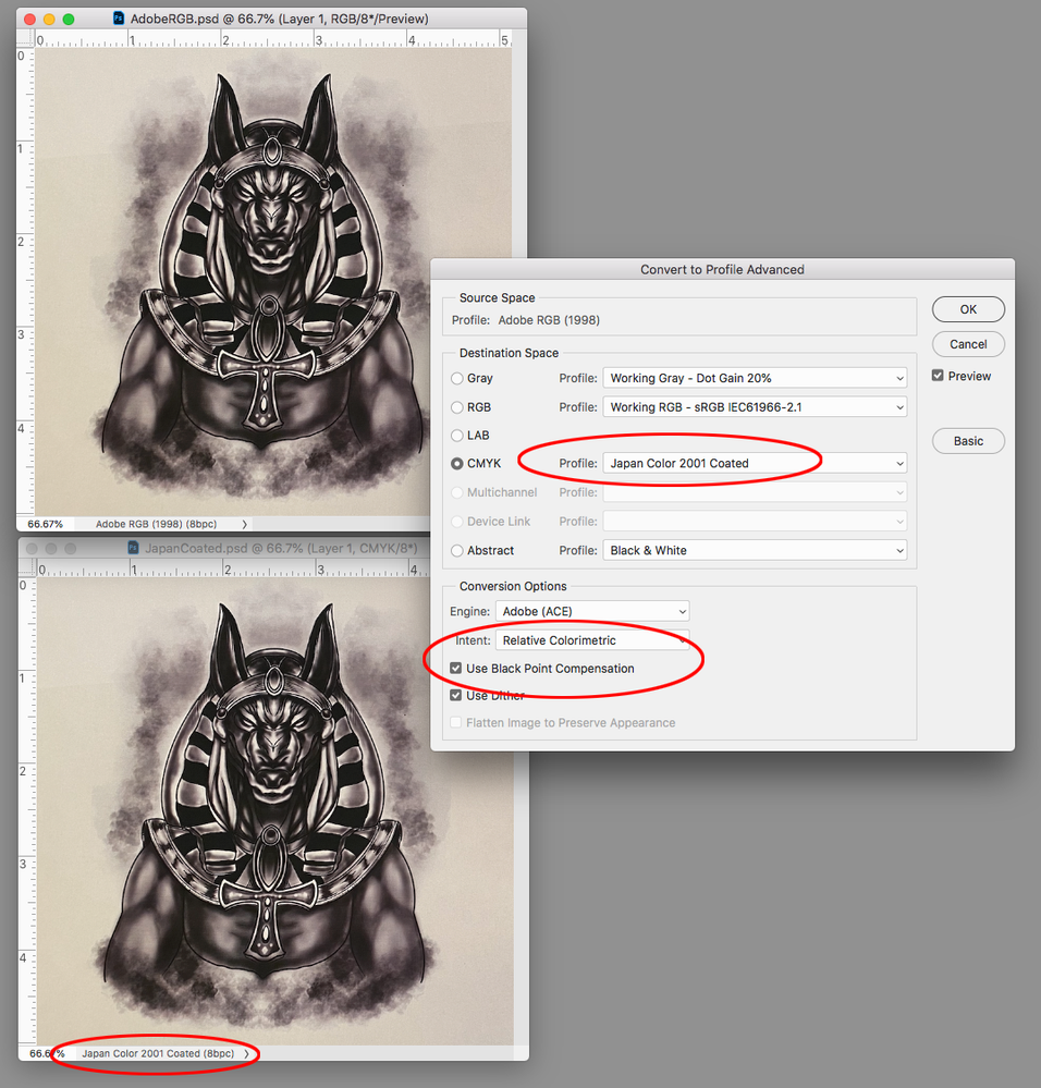

Oct 17, 2020 Oct 17, 2020
So I suppose I have to pick the same profile ?
Yes. If the designer has assigned Japan Color Coated to her AI file, then you should not convert to a conflicting CMYK profile.
While keeping the file as RGB and delaying the conversion until export or output is a more flexible workflow, if it’s required you can still make the conversion to the final CMYK output space in Photoshop as long as you know the destination profile, which is apparently Japan Color 2001 Coated.
If you make the conversion via Image>Mode your current PS Color Settings are used to make the conversion. It might be better to use Edit>Convert to Profile where you can specify all the conversion options. Relative Colorimetric will attempt to maintain the color appearance when the color is inside of the CMYK gamut :
If I place the AdobeRGB version and the Japan Color 2001 version in a CMYK AI file with Japan Color 2001 as the profile assignment, the output values of the 2 versions will be identical:

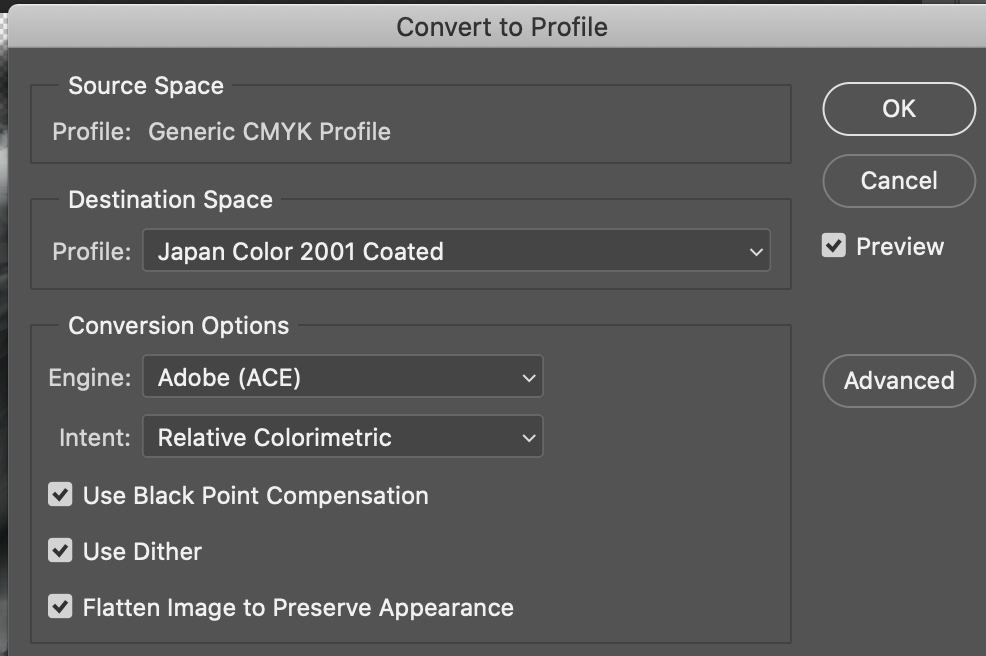

So I've tried as you suggested (Edit > Convert to Profile).
Here I'm converting a CMYK Generic Profil file (the design has been created using this profile) to the Japan one:
Flatten the image is ticked by default, so I guess I haven't to do it manually as I was doing before.
I click on OK and apparently it is converted to Japan Profile.

Ok, I switched my photoshop in English, it will be easier.
So after the conversion, I have this untagged CMYK:
Instead of the converted Japan profile 😞
And here are my color settings:
And here my Convert to Profile:
What would be wrong this time ?

Oct 18, 2020 Oct 18, 2020
The conversion you are showing is from Generic CMYK to Japan Color Coated (a CMYK-to-CMYK conversion).
Do you have the original RGB version of the artwork? The ideal would be to make one conversion—RGB-to-CMYK—rather than your RGB-to-CMYK1-to-CMYK2. A conversion directly from the original RGB space using Releative Colorimetric will maintain the original color, which is what I assume you are looking for.

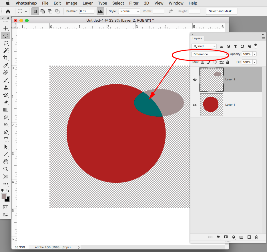

You don’t have to flatten on the conversion, but if you are using certain color blending modes they will function differently if they are not flattened, and you might get an unwanted a color shift.
For example the Difference blend mode works differently in CMYK mode than it does in RGB:
