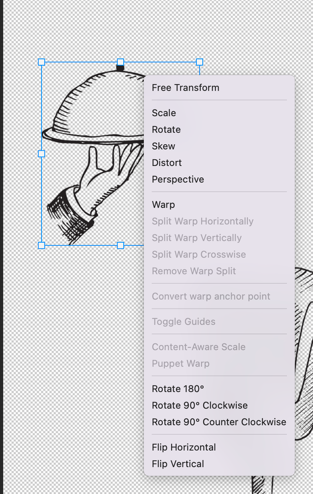

First, this is not a dumb question. I had exactly the same problem.
Second, I know that this is a very old question. But, as I finished in this thread looking for a solution, I will post here what I have discovered to perhaps help other that finish here too.
And third, do not believe those would-be experts that only say that this is the normal behaviour and nothing can be done about it. The context menu is far more useful than the layers one, and anyway you can choose what you want. Here is how:
* If you select the Move Tool as in the picture "error.jpg", error appears - you only get Layers stupid menu.
* To correct this error, you only need to select the Rectangular Marquee Tool as in the picture "good behaviour" and the error is solved.
Hope that this can help people that google for this error and end here.
Also I hope that than readers with this problem can read pass all the would-be experts' comments that say that this is the expected behaviour and that nothing can be done to solve the error.
c.pfaffenbichler
November 29, 2022
I fail to see »flip …«, »rotate …« etc. in your screenshot, so while that contextual menu might be more useful to the OP it does not seem to be what they originally described, either.
November 29, 2022
The original question was how NOT display the list of layers, but instead display the context menu that has the Free Trasform and other things. I needed the same. Free Transform is what most people use much more than the list of layers. My answer shows how to get that. It is true that not all options that this person wanted are in the context menu, but I guess that he was just quoting from memory as he could not access to the context menu.
Anyway, this menu is what he and most people want to have when clicking the right button -me included- and not a list of layers that is not very useful for most people.
